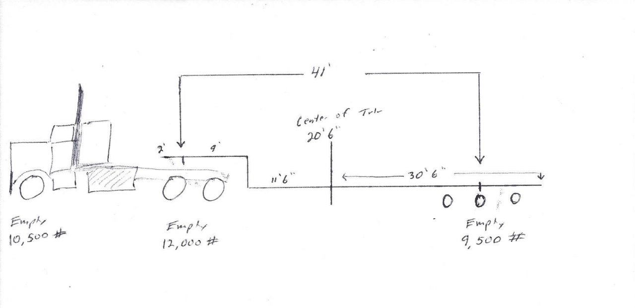

    My hat is off to you guys. I have asked several lowbed and deck guys. Even my kids math teacher and have only gotten blank stares. That formula is going in the permit book.
    Tried to put a pic of the trailer on last night but the computer won the fight. Scan0004.jpg
    [True empty weights are a guess at this point.]
    In the example given [70,000# by 30' long].
    The load would work.
    Center of load 26'4'' behind kingpin.
    Would have 2'4'' space between the drop and load.
    [ 26'4'' - 15' half of load - 9' top deck]
    And 9' 8'' from the rear of load to rear of trailer.
    Steer axle 12,000#
    Drive Axle 35,500#
    25,000# load + 12,000# empty wt. = 37,000# -1,500 # transferred to steer axle.
    [ I only have 36,000# drives ]
    Trailer group 54,500# [ 5,500# to spare on most permits]

    You're light on the drives. Even with 36k axles you'll still be able to permit 40k in most states on a tandem so at 70k payload you'll have 11000 lbs to play with. The math is right tho.

    Really? They will let you go over what the axles are rated for?

    Yes the permit office will, because they can't visually inspect your unit. If the scale decides to come out and check your door post for manufacturer ratings, and you've exceeded them...not so much!
