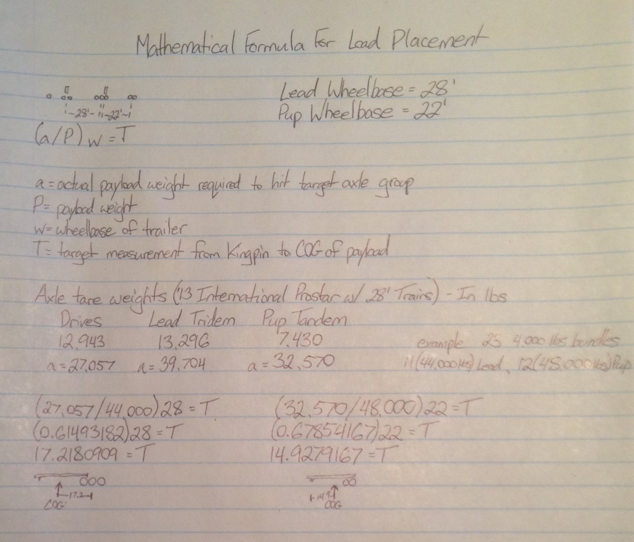

    An old timer loading at a steel plant offered to teach me this information if/when I found out the empty axle weights with my trains. Anyway, good posts here.
  10. Dye Guardian
    Dye Guardian Road Train Member
    1,329
    12,583
    Jan 10, 2015
    North
    I think I have this right, how does it look (B-trains)? Goal of maxing drives and the pup's tandem, while letting the lead's tridem take care of itself.
    Unfortunately, after 3 or 4 loads, I haven't ended up going back to that steel plant.
