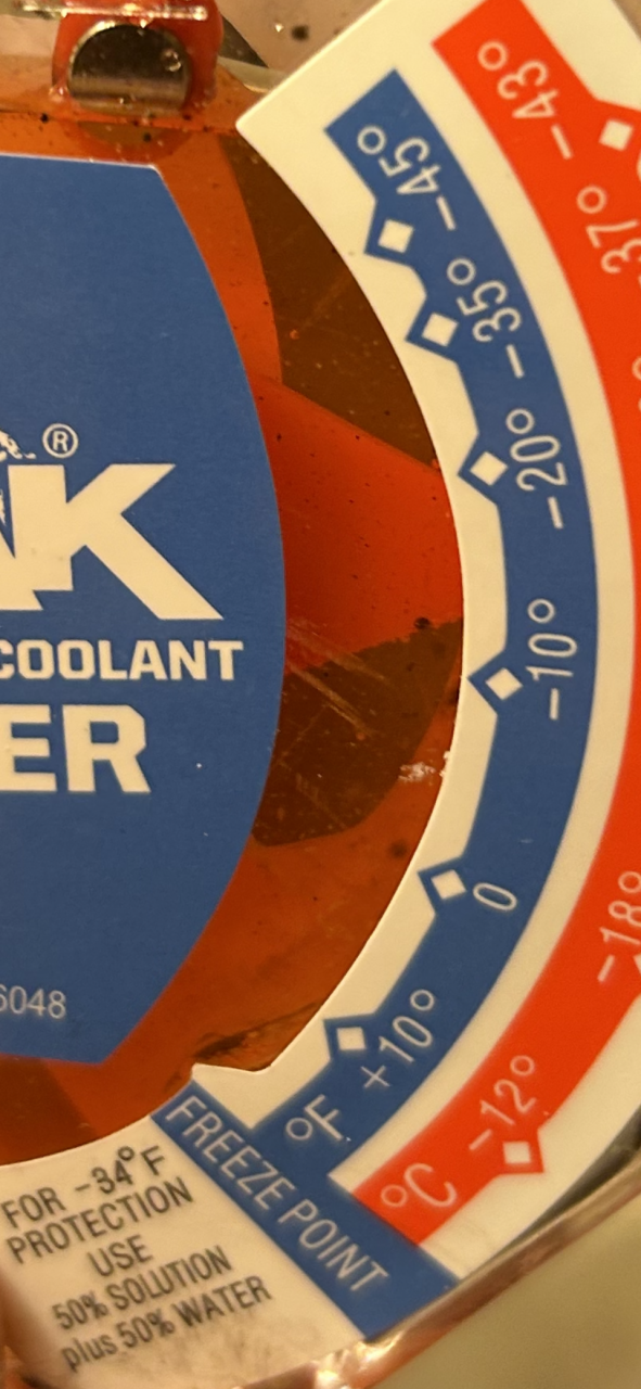

    D58BC8B6-EBDD-4554-B96F-4B8C234A7364.png I broke down and spent $4 Good to -15. I’ll drain it, as suggested. Also drain the last of the coolant from oil pan. Check oil level start it and let it run for 30 seconds or so. Should be OK sitting a few months?? Might already be rusty?? It’s been sitting 30 days. It’s in the 20’s already up here. I hate it. Every year I run out of time to get things done.
