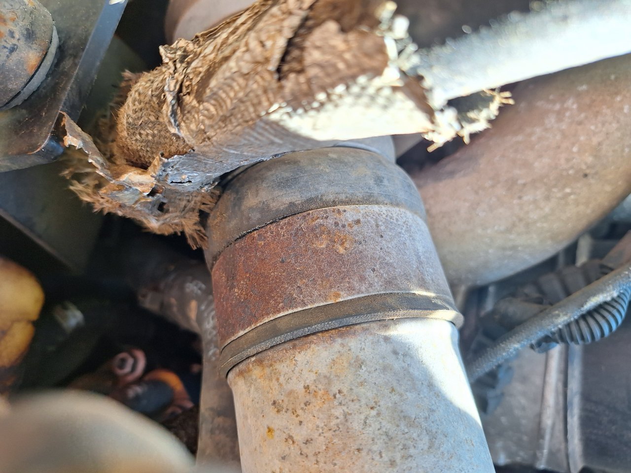

    I found this on the charge air cooler pipe right before the turbo. Hiding behind a coolant line. It was rubbing a lot there and was just a matter of time before it rubbed a hole. What do you think, Is this what a leak looks like? I have new hoses and clamps on the way.
    Also I finally found a shop to road test my truck. I have been searching for sometime for someone that knows these engines. Fingers crossed.
