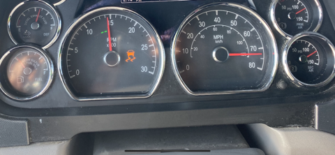

  8. Doealex
    Doealex Medium Load Member
    597
    1,132
    Feb 21, 2018
    You might be right with your rpms. Friend of mine sent me a picture of his 2016 peterbilt with 12.8 packard engine 10 speed manual dashboard last week. Both Pete and KW are manufactured by packard so your truck is probably geared the same so 1100-1150 is good. 98ACFB49-482C-41F8-8797-5BE4909F707C.png

  10. Dave_in_AZ
    60,588
    423,918
    I'd check your owner's manual and see where the green rpm band starts.
    Typically the green is the peak torque with the lowest amount of HP.
    My Cummins is 1250 at the minimum. I typically run at 1325 for max mpg, without beating up my engine.
    Midwest Trucker, x1Heavy, PE_T and 2 others Thank this.
