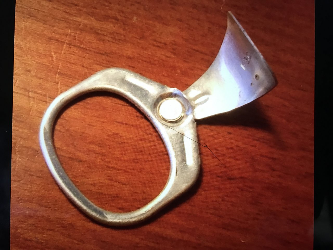

    Sometimes the smallest things can help limp you in. Used a pop can tab like this to keep the trailer lights on for over 100 miles,
