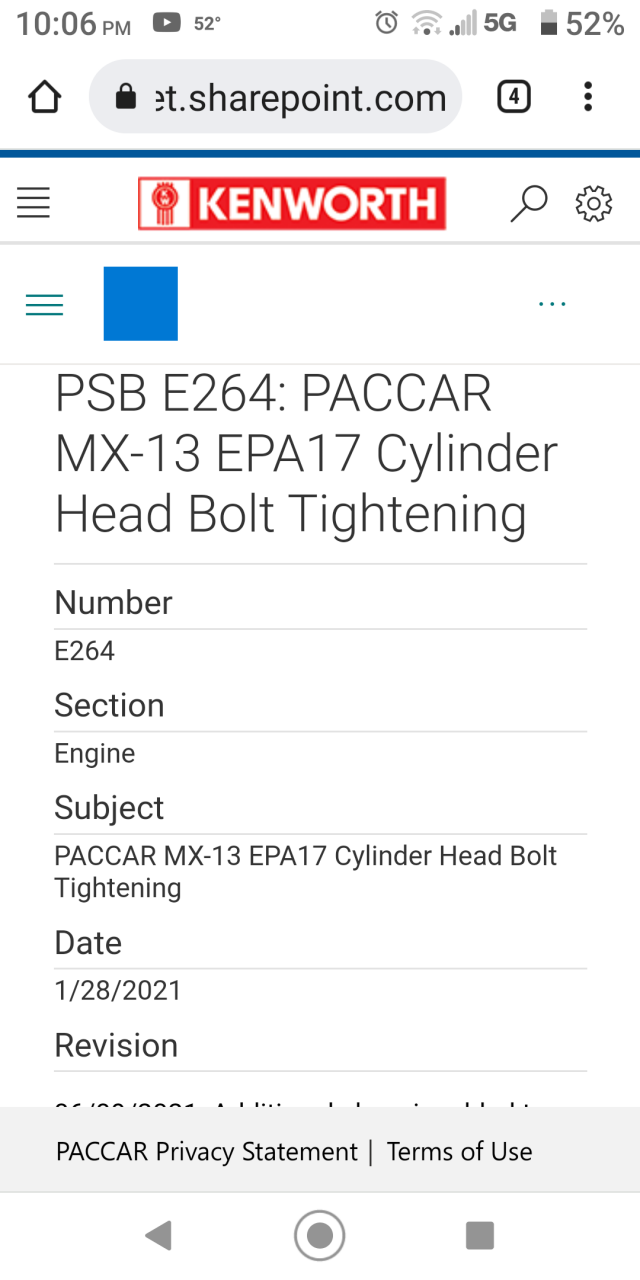

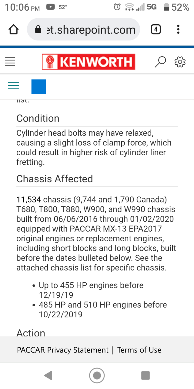

    Also I'd check EGR cooler before pulling head, but they rarely fail nowadays. Had a campaign to re-torque head bolts, was yours checked for campaign? Screenshot_20220420-220642.png Screenshot_20220420-220625.png
    A5¢ and Short Fuse EOD Thank this.
