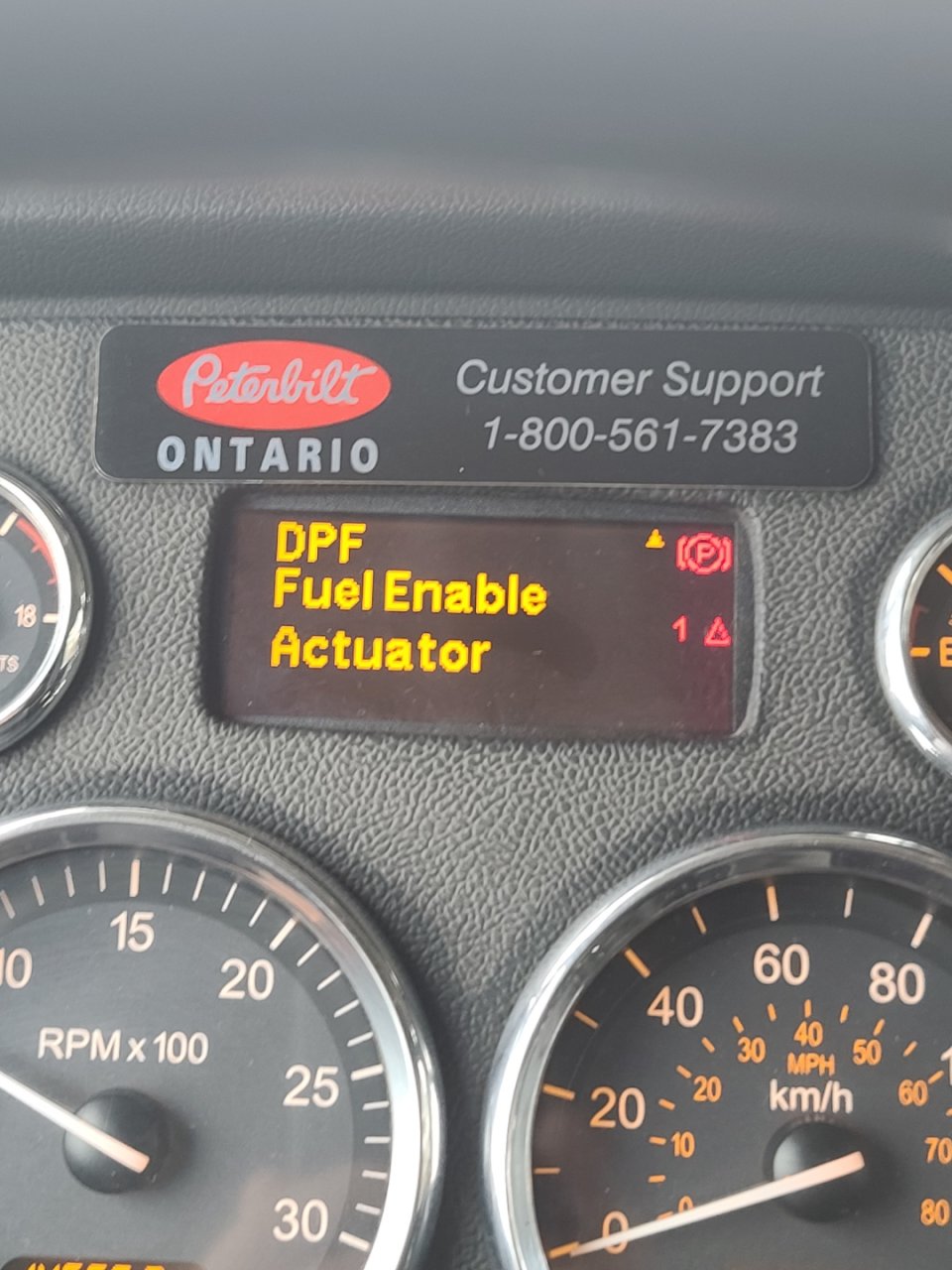

    Hey guys truck has been sitting for almost 3 years.
    2013 Peterbilt 386 with a Paccar MX13 epa10.
    Got 2 engine codes that came on,
    Dpf fuel enable actuator
    Egr delta pressure
    Could this happen from water in the fuel? Winter fuel from 3 yrs ago

  5. steve092

  6. Goodysnap
    Goodysnap Road Train Member
    3,771
    9,195
    Jul 12, 2017
    Aftertreatment Fuel doser or 7th injector is likely plugged. If driven with fault active EGR derate is enabled and must be shut off with Davie. Regular doser cleanings are needed on EPA 10 they plug over with carbon quite often, worse with high idle and light load.

  7. steve092
    steve092 Light Load Member
    298
    80
    Dec 7, 2015
    It's creating a blue haze smoke from under the truck. I tried cleaning the 2 small tubes right after the egr sensor but lights came back on.

  8. Goodysnap
    3,771
    9,195
    Jul 12, 2017
    Hard to tell without actual fault codes
    The first is most most definitely related to DPF fuel dosing. What I have given you is most common issue.
    Second is EGR derate emposed, likely from above problem. Dont go crazy changing or checking EGR parts because it just needs the derate reset after the root cause is fixed.
  9. steve092
    298
    80
    Dec 7, 2015
    Is cleaning both the doser and 7th simple to do? What should be used to clean them. Peterbilt couldn't even pull any engine codes out everything was inactive. This is what comes on after driving for a bit and goes away when you shut the engine off and on. Resized_20201222_101439.jpeg Resized_20201222_101432.jpeg Resized_20201222_101439.jpeg Resized_20201222_101432.jpeg
  10. Goodysnap
    3,771
    9,195
    Jul 12, 2017
    Far from DIY. You need Davie to run the flow and leak text and also to reset the derate. Accessing the doser for cleaning on EPA10 is also a PITA. This is also considered to be routine maintenance along with DPF cleanings.
    Find a good shop that can TS and find the problem. Did pete log a regen and did it complete a stationary? This type of issue really should be straight forward for a dealer. If the faults come and go it may be a intermittent wiring issue. Again really need to see printouts for exact codes.
  11. steve092
    298
    80
    Dec 7, 2015
    They did a forced regen and removed the derate that's all. He saw the blue haze smoke and said injector is leaking never specified which.
    The lights come on after driving for a bit they go away when you turn off engine and back on but come on shortly again. It did this for quite a while till the engine light for derate came on and would not go till dealer removed it.
