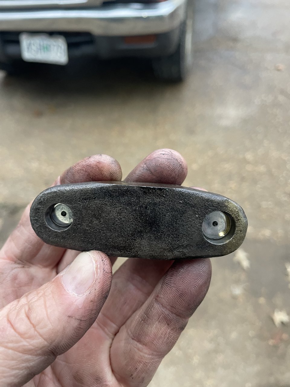

    As you can see and if you were unaware, the valve bridge has a larger hole on one end. Is there a specific direction(driver vs. passenger) IMG_6082.jpeg that the larger hole goes?

    Not to step on toes, but you would be surprised the number of people who ignore the notes because they are expecting that important information to be written in the line above and therefore miss it. So I'll repeat it,
    Larger hole to the exhaust side!
