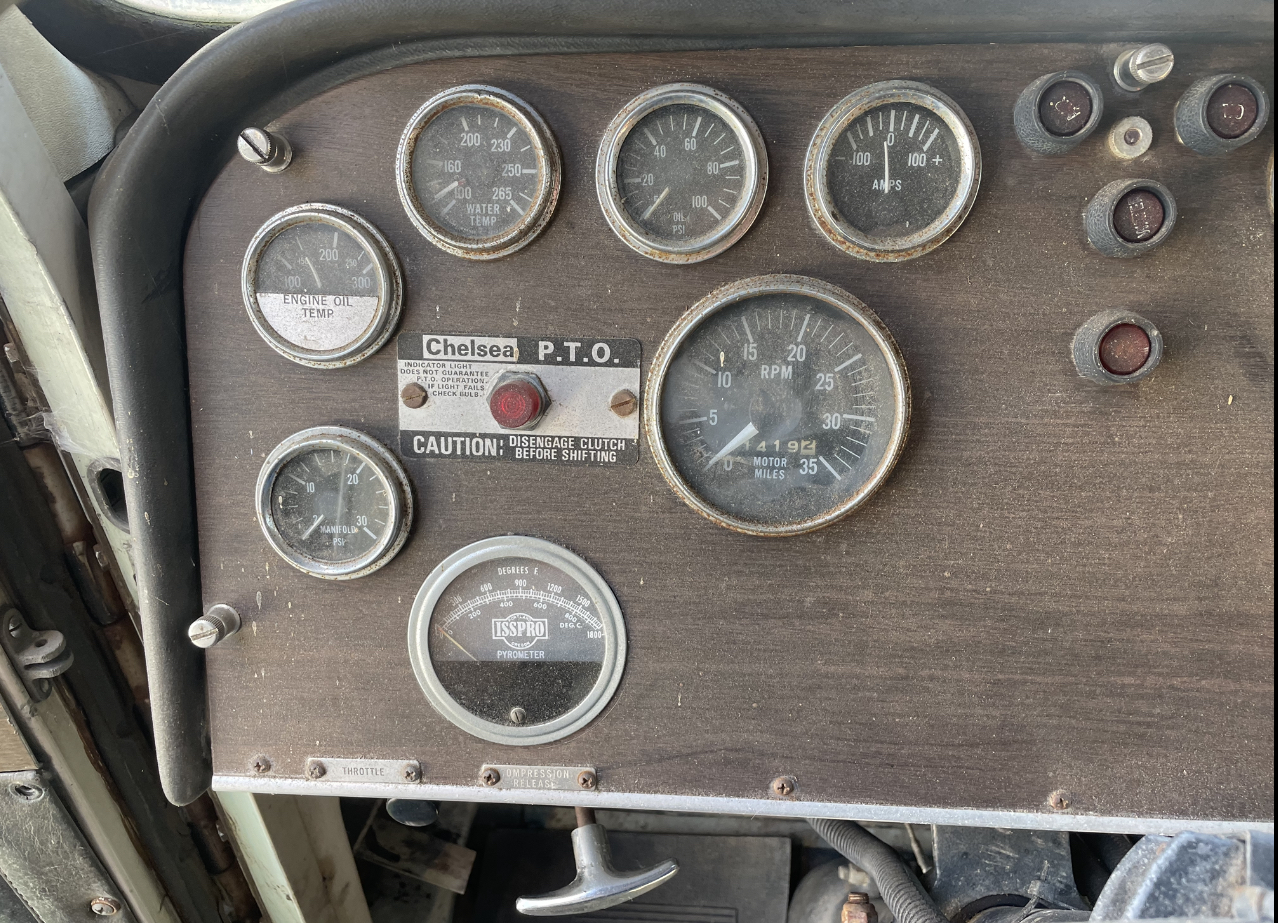

  7. OLDSKOOLERnWV
    19,193
    290,317
    Notice the T handle under the dash right below the pyrometer? That’s the compression release on this old 76 Pete. Something similar to that is what your truck would have, in the event you would want to hook it back up in the future….

  8. Big Road Skateboard
    7,196
    40,864
    May 2, 2021
    100$ says a new CDL school graduate would grab it to pop the hood...
  9. campwells
    campwells Bobtail Member
    11
    7
    Jan 13, 2025
    I’m not putting collared exhaust rods back in just to make sure this never happens. Unfortunately I’m in California so with our weather I doubt I’d ever need it to work. Maybe to help prime fuel or oil but I don’t see the need for it. Maybe one of you actually truckers know different- school a newbie if so.
