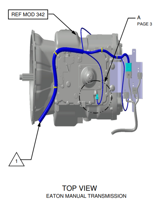

    Note that you have an eaton 10 speed specd in your truck. Therefore your trans should look something like this:
    Note the dashed circle "A" which corresponds to your two pin reverse lamp switch.

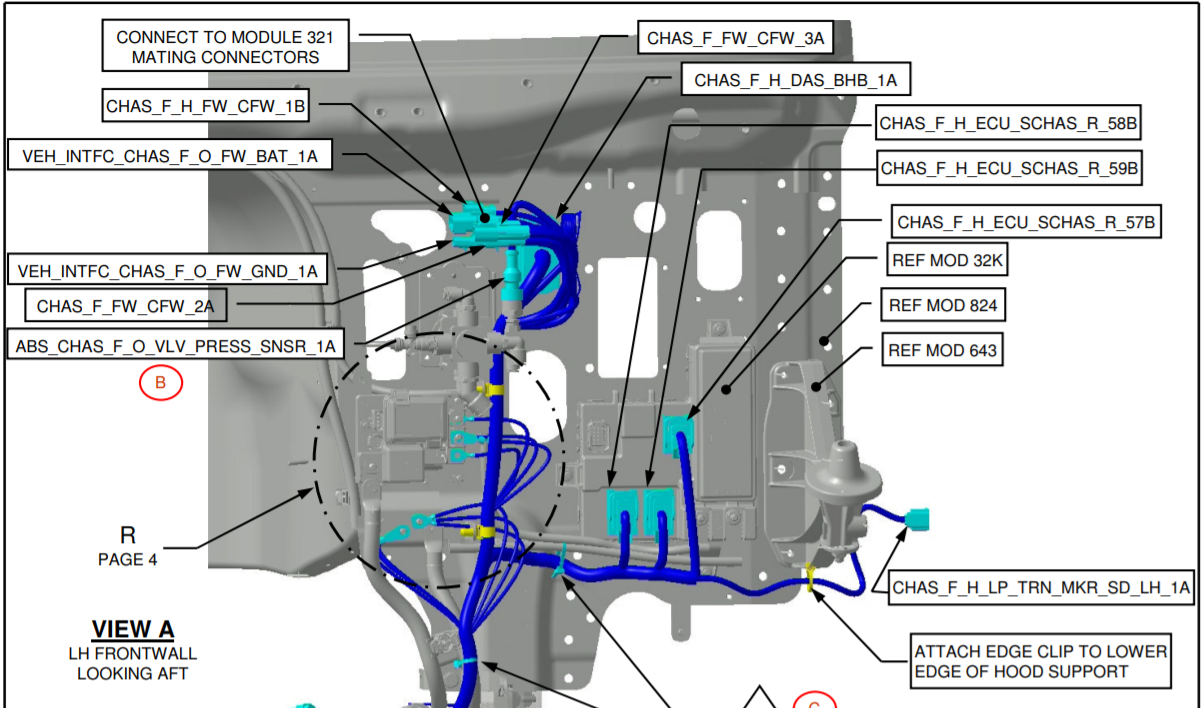

    Here is the installation diagram showing as such. Open the hood and you'll see it on the firewall on the driver side. BHB is marked on this, then closer on the outside is the BHA. Under BHA you'll see the SAMchassis:
    We're looking for connector X59 and X58 for input an output respectively.
    THis should be MORE than enough information for you to solve your issue with basic inspects and checks. If any of that seems too complicated to your or you don't understand, then I would suggest taking your unit to a certified FTL dealer.
