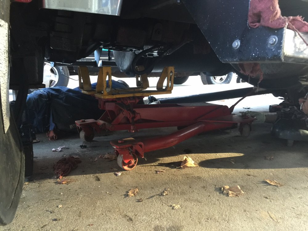

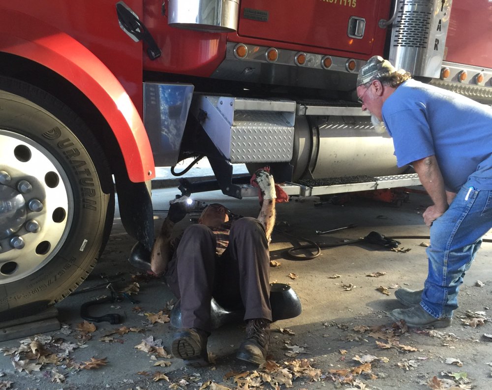

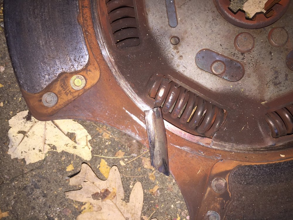

    The clutch and flywheel are out. The clutch was still good but was maybe 99% used up. It took one guy 4 hours to do it with the help of another guy the last hour. There were some broken springs. The major culprit was that broken piece in the 3rd pic. It goes right there but you can't see it. You can see where it was spinning around and scratching the metal. That accounts for the clutch working some times and some times not. The flywheel goes out for refinishing today.

    So it was a spring just like we said! I would have put money on it.

    Not really. It was that big piece of metal getting wedged and preventing the clutch from pulling away from the flywheel. That piece is pretty big. Maybe 4" long and 1/4" tall.

    Was that part of the clutch plate in the pic? I was wondering how it managed to break off. Seems unusual for something to break off like that. Anyway at least you managed to drive home, there's nothing worse than fixing a major job a long way from base.

    There was a few pieces of spring in there also. Maybe they got hung up and broke it off. Not sure. That explains why sometimes the clutch would work fine and sometimes not at all. Of course it worked fine once I got home.
    I can't believe all the special jacks he has. The one the flywheel is mounted on in the picture is just for taking it out and putting it back in straight. It has all sorts of adjustments.
    The flywheel surface machine was pretty cool to watch. The flywheel sits flat and this spinning cone made of stone and diamond chips cuts it.
