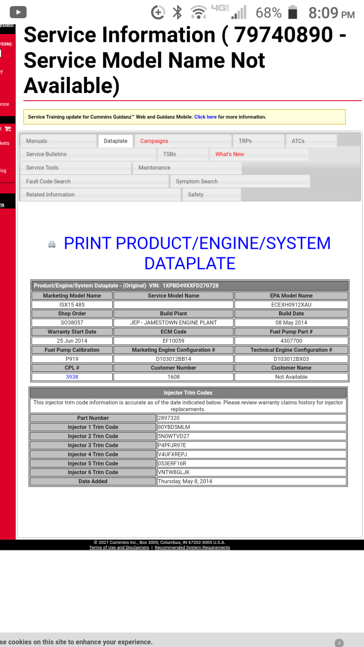

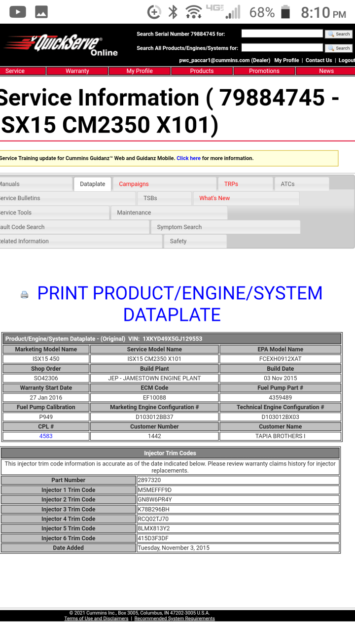

    It is low mileage 185k, now, from a wreck. Old ESN 79740890 new ESN 79884745 both 2350s. The EGR assembly from the cooler, but not including the cooler, to, and including, the crossover pipe and everything on the left side of the engine except for the fuel pump and plumbing to the injectors, which pretty much had to stay with the new one, is from the old engine. The injectors, pump, turbo and actuator and ECM are original to the new engine. The dealer when connected to tier 2 did one or two little tweaks to the ECM that didn’t change my issue. Then whatever they tweaked was negated with the latest update at Cummins. I’m sure everything matches. Considering buying the EGR assembly, sensors and all, from the new engine if the price is right. He still has it but he’s on vacation ‘til next week.

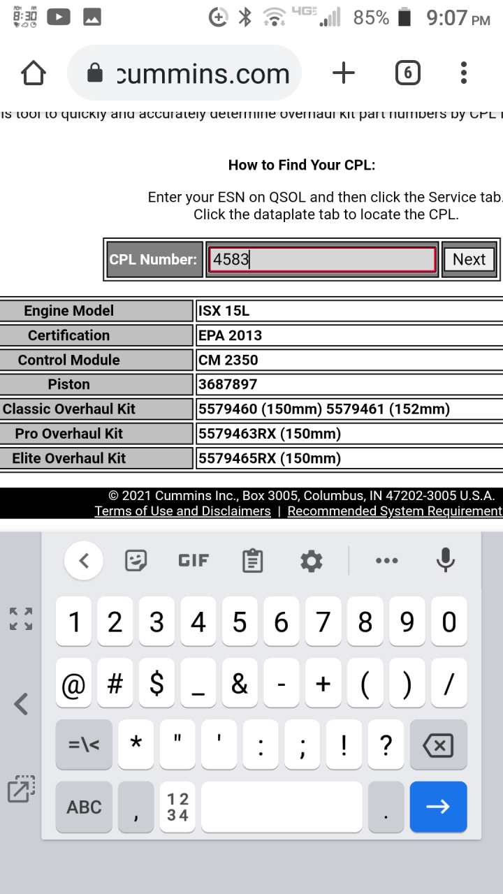

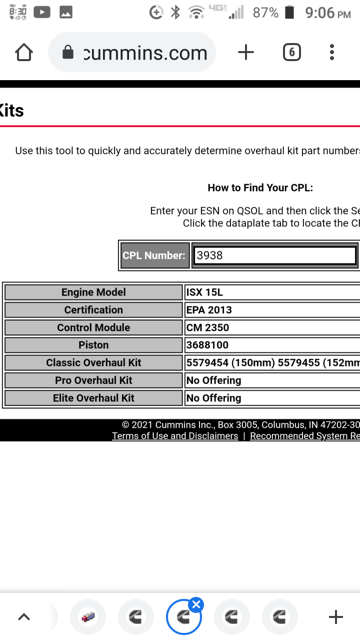

    The CPL's don't match, different pistons and injectors. Screenshot_20210627-201101.png Screenshot_20210627-200946.png Screenshot_20210627-210636.png Screenshot_20210627-210733.png
    So does the software in ECM match the current engine?
