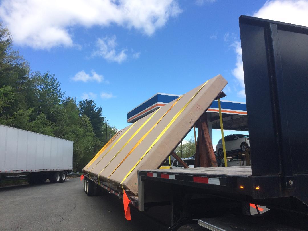

    How are they going to be bolted/loaded to the trailer? When I pulled for UPI (United Precast) here in Ohio, they were mounted by 'rebar screws' to a tripod, and I strapped (of course) for extra securement. BOL said no chains for me, also. This was 5 or 6 years ago, wish I had pix. Had a dumb phone back then...
    This is not the best pic, but it's similar. Hopefully the OS/OD guys will chime in for ya.

    It also depends on how the factory loads the stuff. In our case the double T which i posted elsewhere is more fragile than sheetrock. T beams are thick but we still only throw 3 straps on each end over the dunnage. Flat slabs, chains over dunage and straps for the diff, hard to break. Not impossible.
    The way we have found to do our double Ts is 3 over the front dunnage, three straps over the rear dunnage, and only 1 saftey chain ran through the crane eylets on top and down over the thickest part near the T section pulling slightly back with edge protection.
    Our load bearing walls have frames for support, which let us get very agressive with the securement on those.
    Heres an example from the other day for visual on both a double t and flat slab 20190828_073416_HDR.jpg , but not knowing what kind of precast, or how its loaded cant say for sure. No onsize fits all really. And on the slabs we chain through eyelets. There are more towards the front too.
