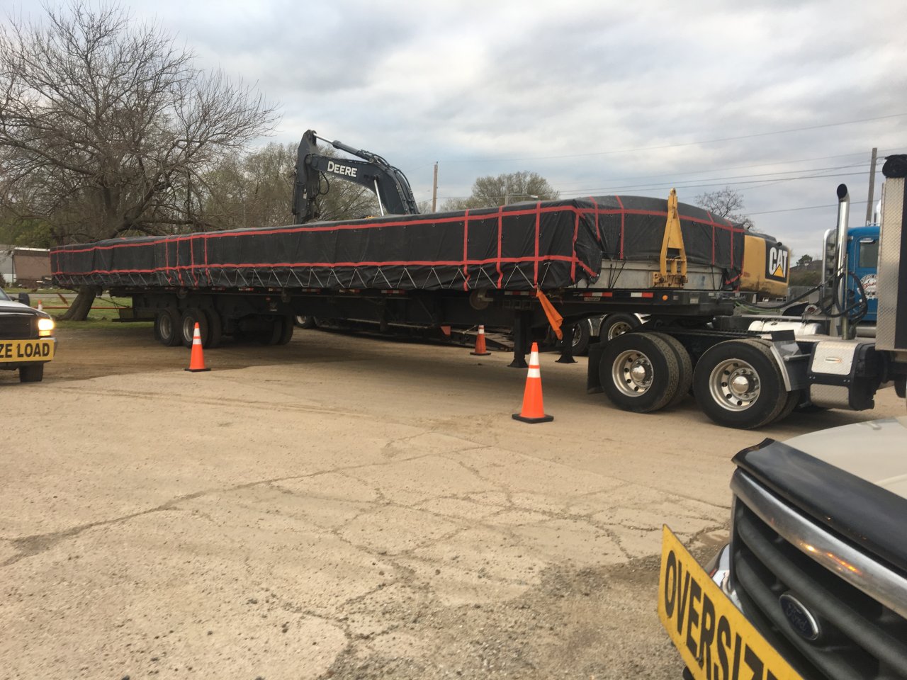

    We used to haul these 16x60 boxes with cloth lids and they always had to be tarpped. We had some special light weight 24x40 tarps made up just for them.
    The first tarping was easy, I would drape the tarps before it was loaded. The tricky part is the customer would unload and reload the box while it was still on the trailer, and we had to retarp it. A few guys fell through the cloth lids walking across them rolling out the tarps.
    I took a 1/2” rope 100’ long and cut it into three pieces. Put a big carabiner on one end and toss them over the load. Roll the tarps out next to the trailer, hook the ropes up, and pull them over.
    Bonus points for making your pilot car drivers work the other two ropes! Works great with three people.
