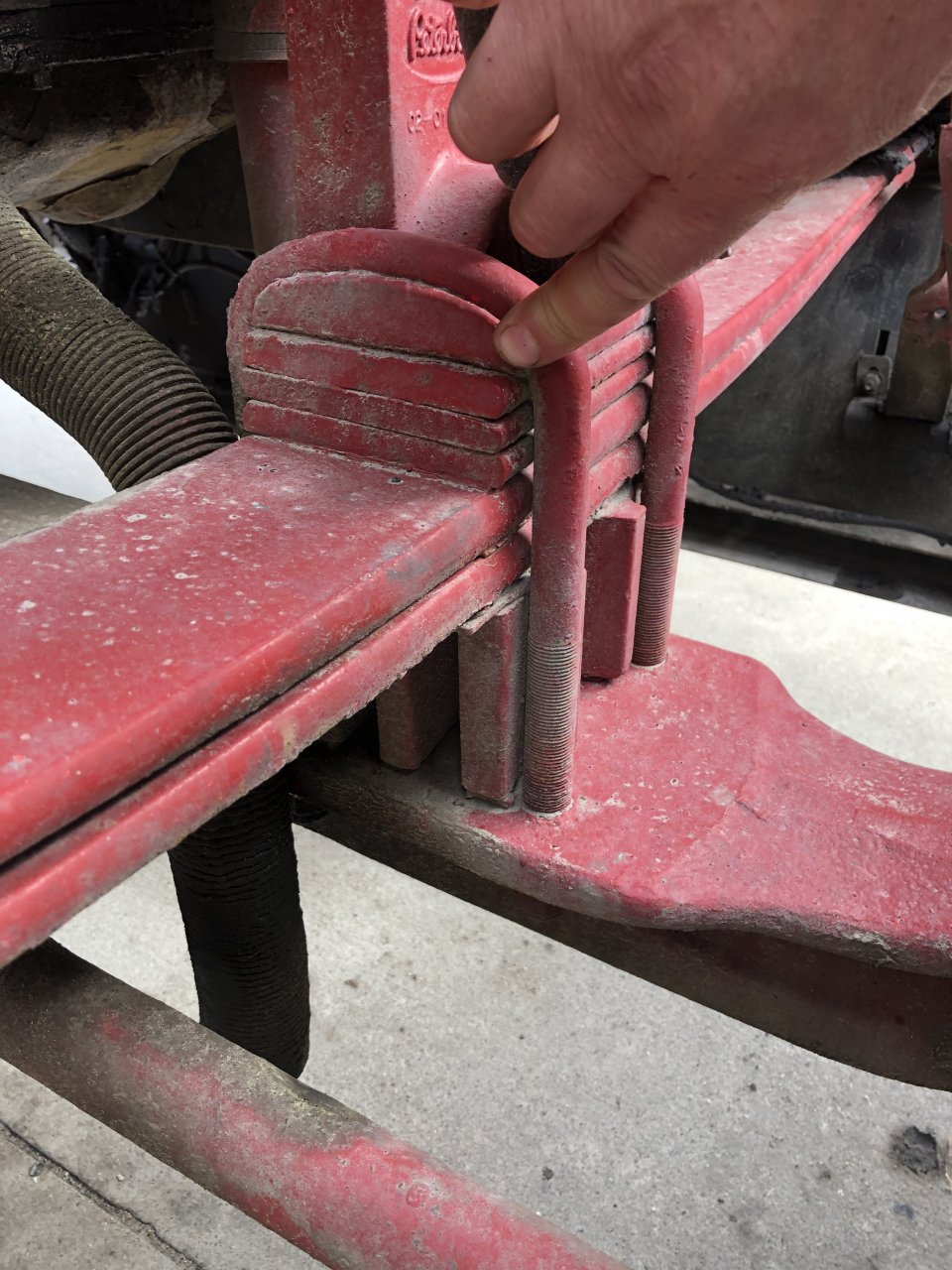

    i have a question regarding a driverside steer axle leaf spring on a 1988 379,i snapped one and got a new one to put in, i noticed that the new speing had 3 pieces of metal on top of it and the driverside broken spring had 1 piece of metal above it and 2 below it, but the passenger side has 3 above it like the new spring, should i just put it in as is or switch plates aroud?

    Your other 2 plates appear to be on the bottom.
    Maybe someone did some custom leveling?
    I'd be changing the springs out for a balanced pair.......

    yes there are on the bottom on 1 side , agreed they shoukd be replaced in pairs but could only get ahold of one at the moment,if i put my new spring in it will match the other side, iv just herd of alighnment shops sometimes doing things like this for road curvature

    I would put the spring in as it is to match the other side with the blocks on top. This is the correct Installation.

    ya i think so to , just wanted second opinion , thanks for the help goodysnap!

    All that does is make your stop closer to the frame doesn’t participate in any of the spring action!

    Yes aligment shops will try to compensate for the road crown, I would put it on as is an observe how it sits and drives. Ultimately though it should go to an alignment shop.
