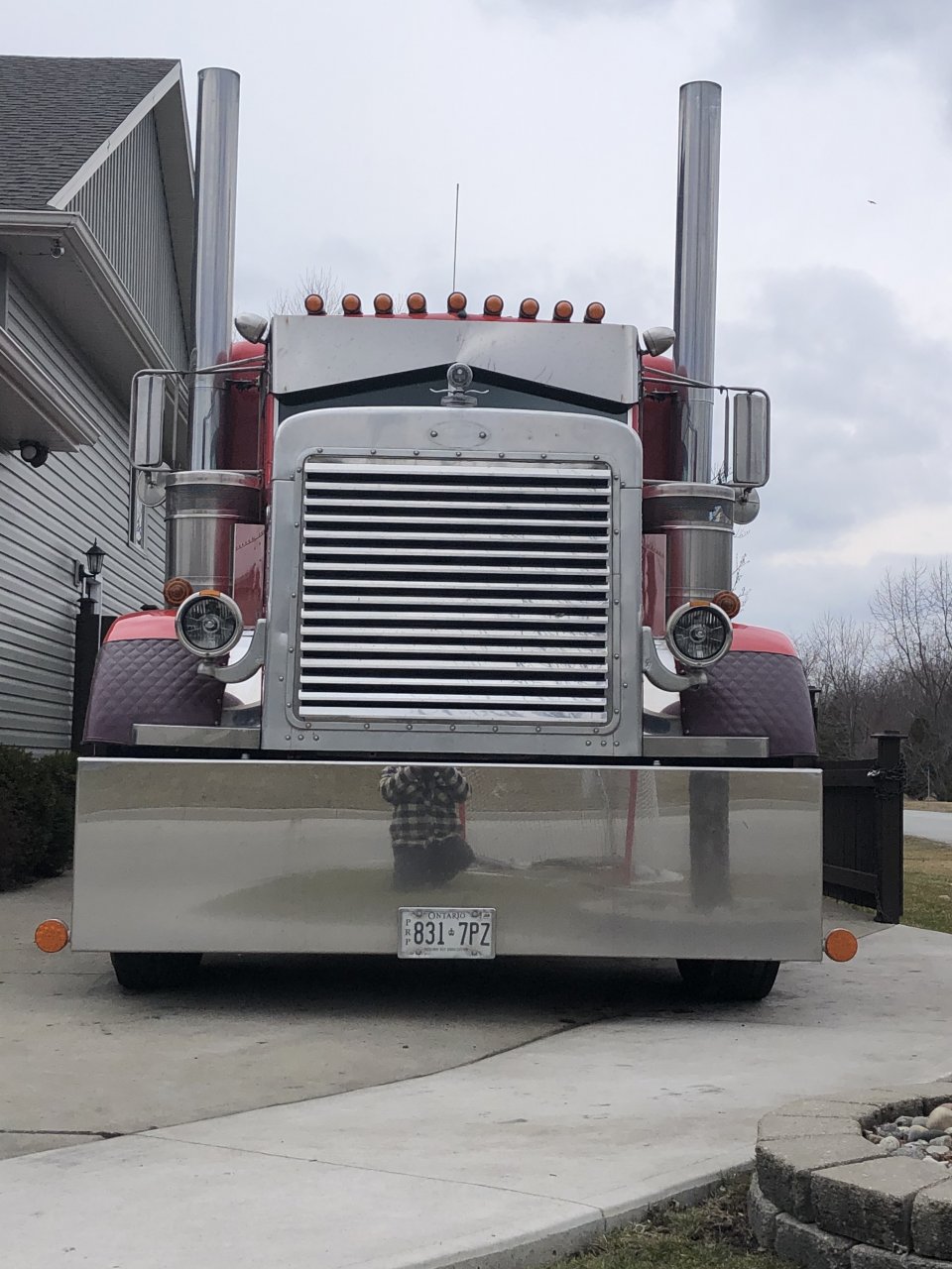

  7. tj379
    tj379 Light Load Member
    237
    226
    Nov 10, 2019
    ontario
    i just installed it as it was, befor job was 8 inches bumper to ground 5.( on broke side 07F4008A-0677-4E11-BC5C-35B42C5007BC.jpeg
    SmallPackage Thanks this.

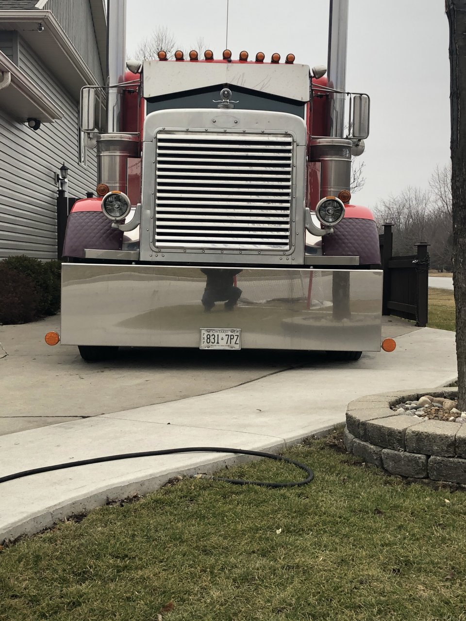

  8. tj379
    237
    226
    Nov 10, 2019
    ontario
    E9D95E42-A0FC-40BD-A387-9CA06CBA3A1B.jpeg 8 inches both sides now with new one E9D95E42-A0FC-40BD-A387-9CA06CBA3A1B.jpeg
    Rideandrepair and SmallPackage Thank this.
  9. tj379
    237
    226
    Nov 10, 2019
    ontario
    see how she goes lilky try to get another one for passenger side next week thznks for everybodys help

  11. Rideandrepair
    17,550
    56,868
    Aug 8, 2015
    Man, that’s a nice looking Truck. I wouldn’t bother changing the other one out, all the weights been riding on the weak spring for so long anyway. The shims are equal and it’s level. Better than a lot of brand new Trucks. Often shims aren’t equal, due to frames being a little twisted on brand new Trucks. It’s perfect now. Your Truck, but really no need to change the other side. The springs obviously good.
