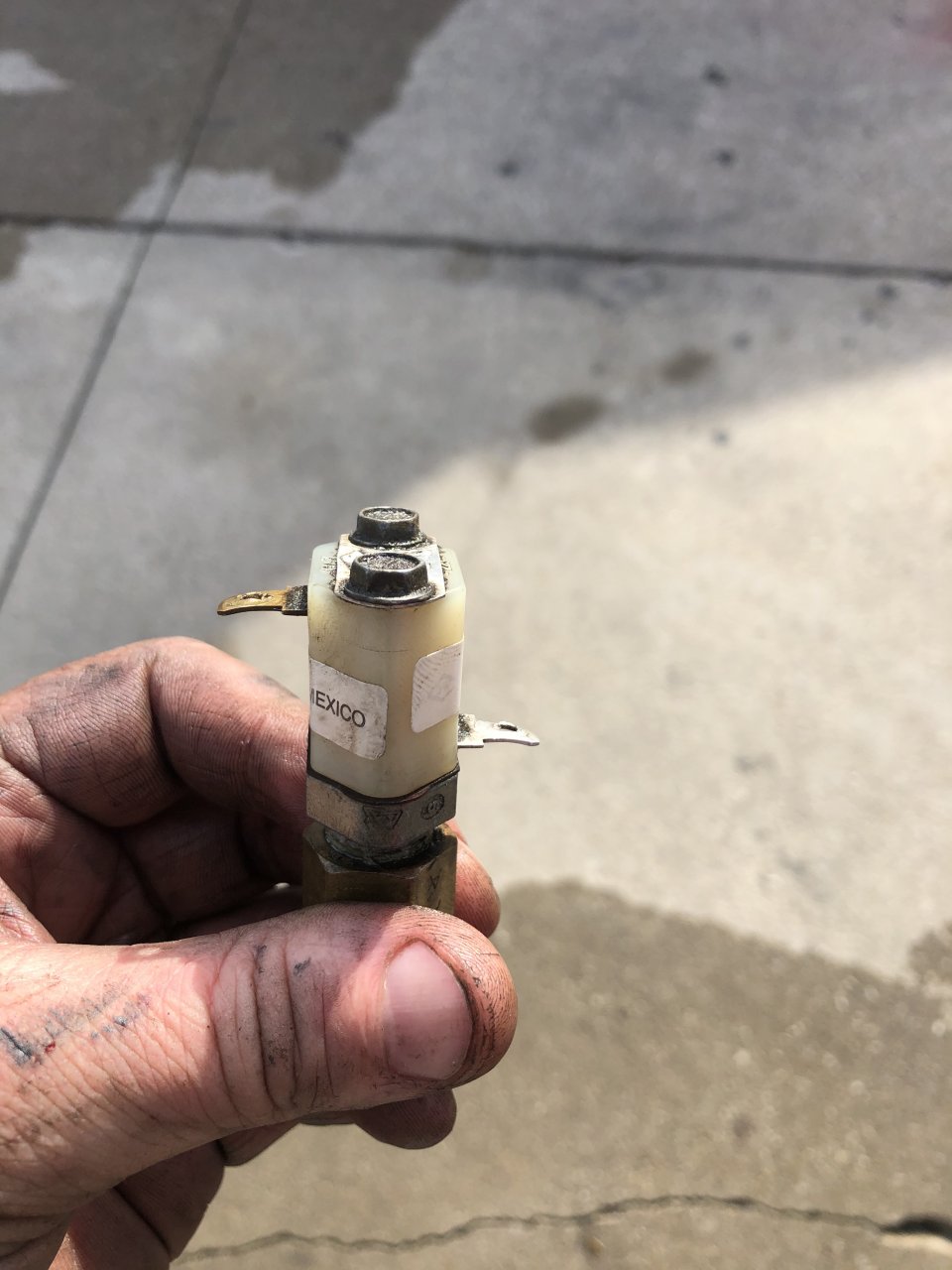

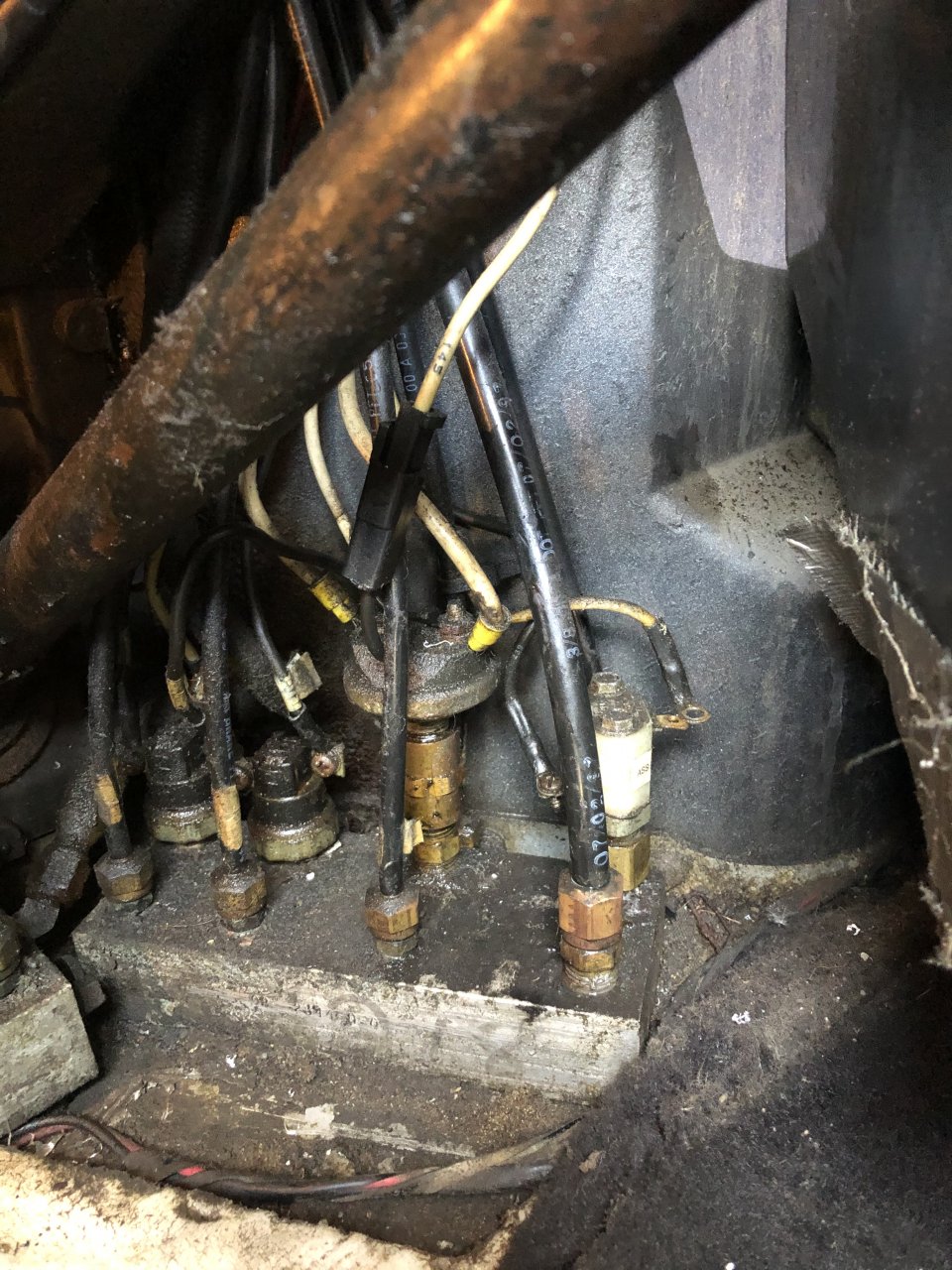

    would anybody happen to know what pressure switches do what or a scematic of a 1988 379 air manifold behind the fuel petal?i have a small air leak on a low pressure switch, i rdmoved it and plugged for now but cant figure out what it does! my bk lights work off spike n petal, low air lights are good, interaxle light good, fan etc

    Low air buzzer maybe? @pushbroom may be able to help

    that is what the switch looks like and the location is the very right rear or back side of the manifold , was wondering if tge engine idel timer uses one of these?

    the low air light works , buzzer never has so that could be, if thats the case it can stay plugged!

    Bendix low air switch. Buzzer?

    Most of the buzzers in a peterbilt that I’ve seen are unplugged at the board, including the truck I have now.

    ya im thinkin its a buzzer , i havent noticed anything not working, thanks for the replies
