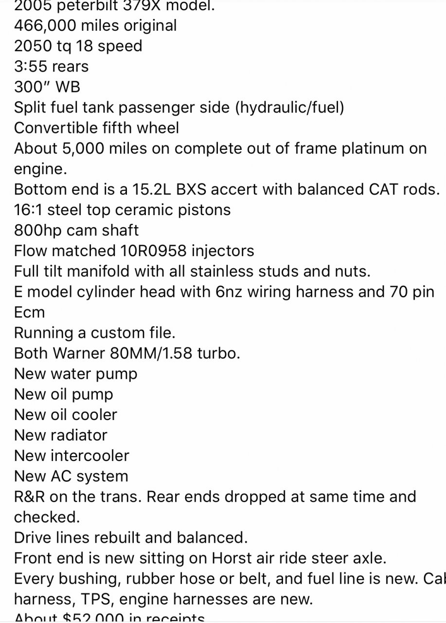

    Im looking to buy a used truck, and i found one im really interested in, its a 05 379 with a 99 cat but the owner said it came with a cummins and he swapped it out for. Pre eld motor. But i thought thats not legal or something along those lines. Because i asked the same question here before but its been really long. I had a 2015 389 and i was wanting to swap motor out for pre eld and i rmr being told thats not how it works.

    So its a legitimate way to be eld exempt? And is this a solid setup he has?

    I dont think this set up is ELD exempt ...block is from 2005 since its acert ... Others might chime in to have more info...

    No bueno; BXS C15 began production in 2004.

    It could be an Emodel thats had an accert crank thrown in it. One would have to get numbers off the block itself to verify it.

    It says right in the description that it is a BXS C15 Acert block.

    There has been so much monkied with on that engine I wouldn’t trust any descriptions and would verify by part numbers cast into the block and other major hard parts that I have laid my eyes on personally.
