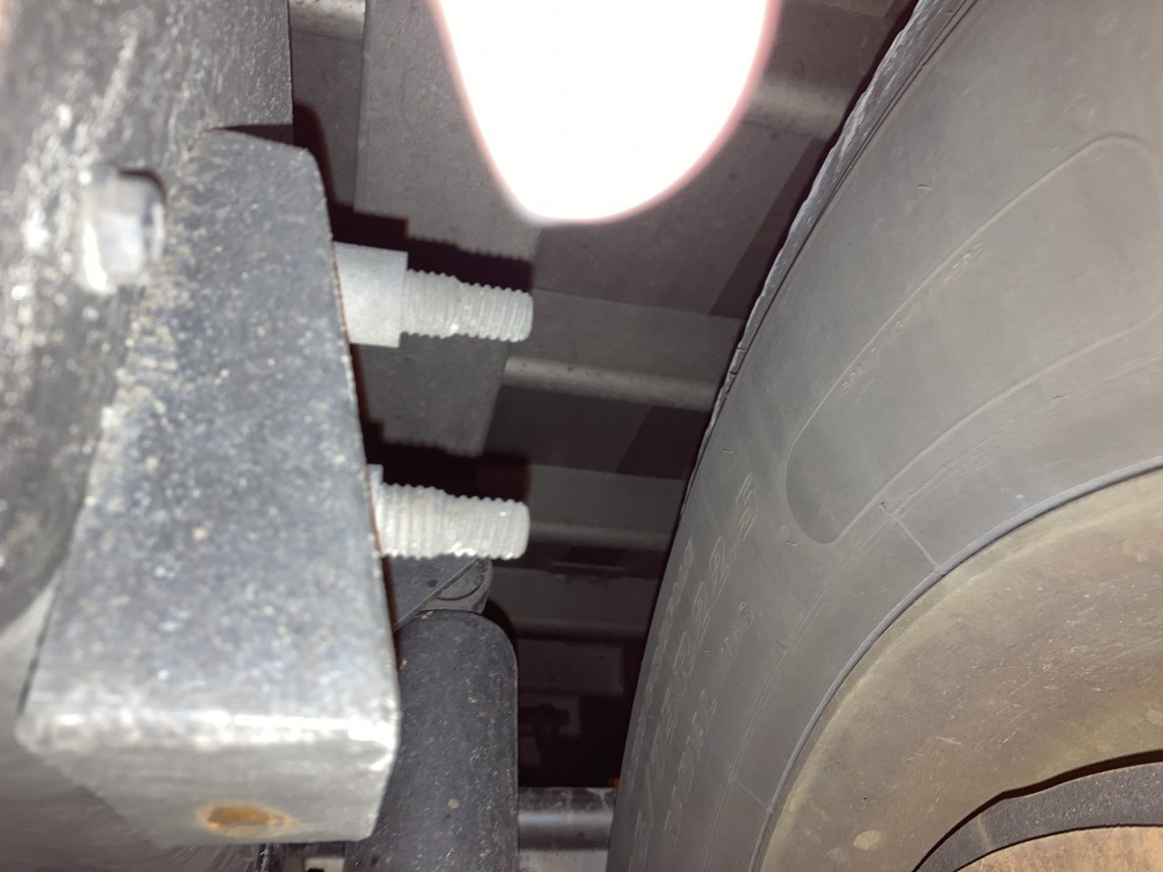

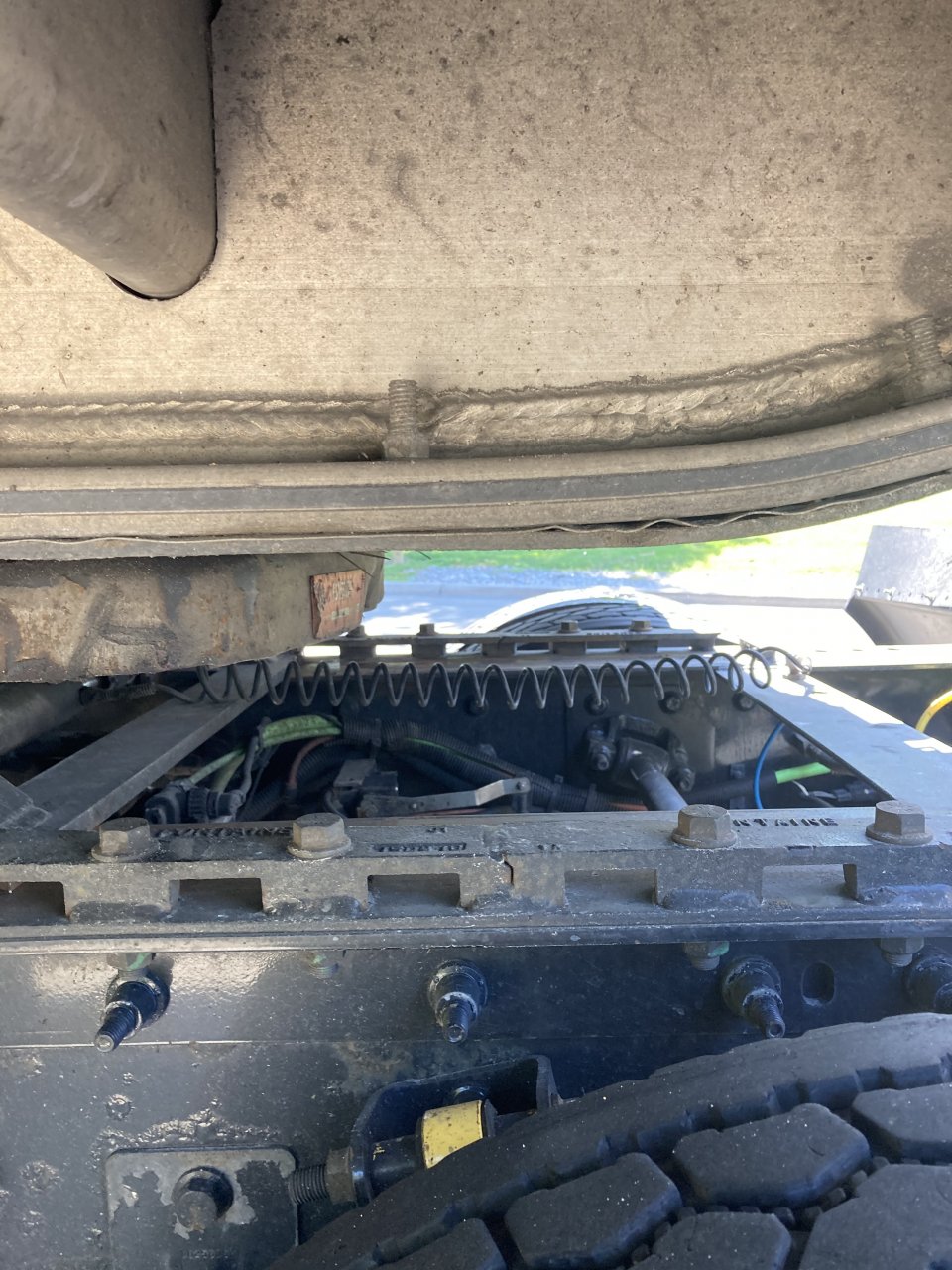

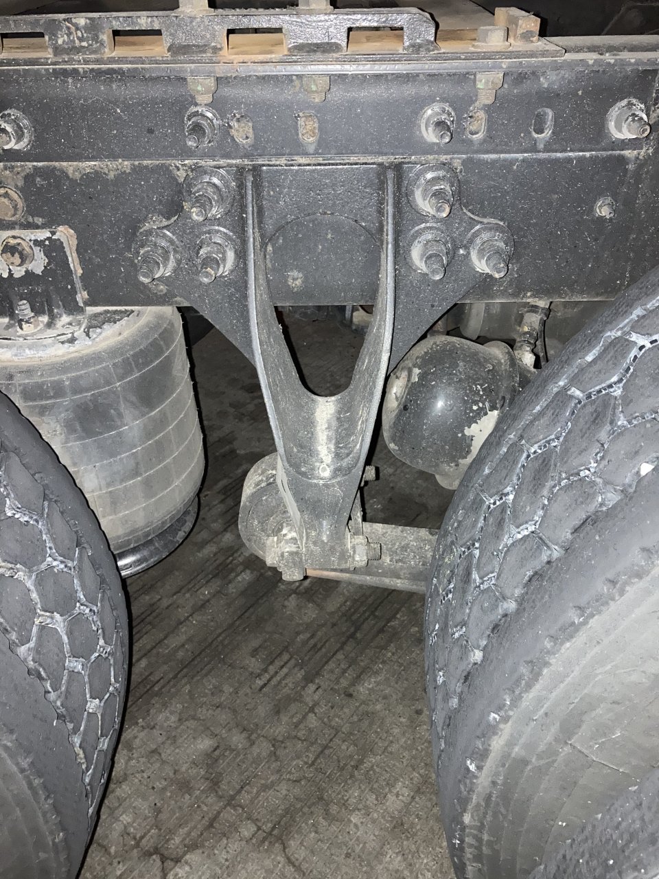

    Looks like ubolt and bump stop are touching on all 4 corners

    Yep, that is just regular IROS suspension. So top of the Ubolt to bottom of axle stop at the ubolt nearest to the leveling valve. The touch marks between the ubolt and stop will happen when suspension is dumped or all air is leaked out of the bags too when sitting for a long time. Check the height with a loaded trailer on it with air pressure at a full charge.

    Never mind how the rod points. What is important is the dimension between the ubolt and stop.

    Just measured it with engine on,parking brake released and on level surface,im about half an inch under 2.75
