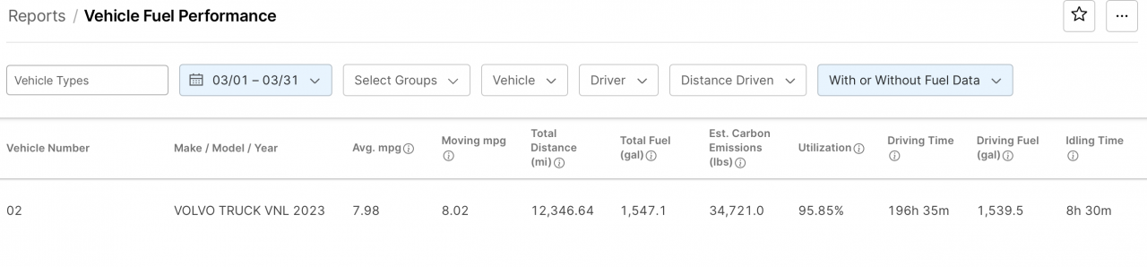

    Also if you have Motive as a ELD you can search under this Reports /Vehicle Fuel Performance and it will give you plenty of details to see if it is an idle issue or not. Can look through any week or day to verify. Here is my report from March Screenshot 2025-04-07 at 6.52.11 PM.png
