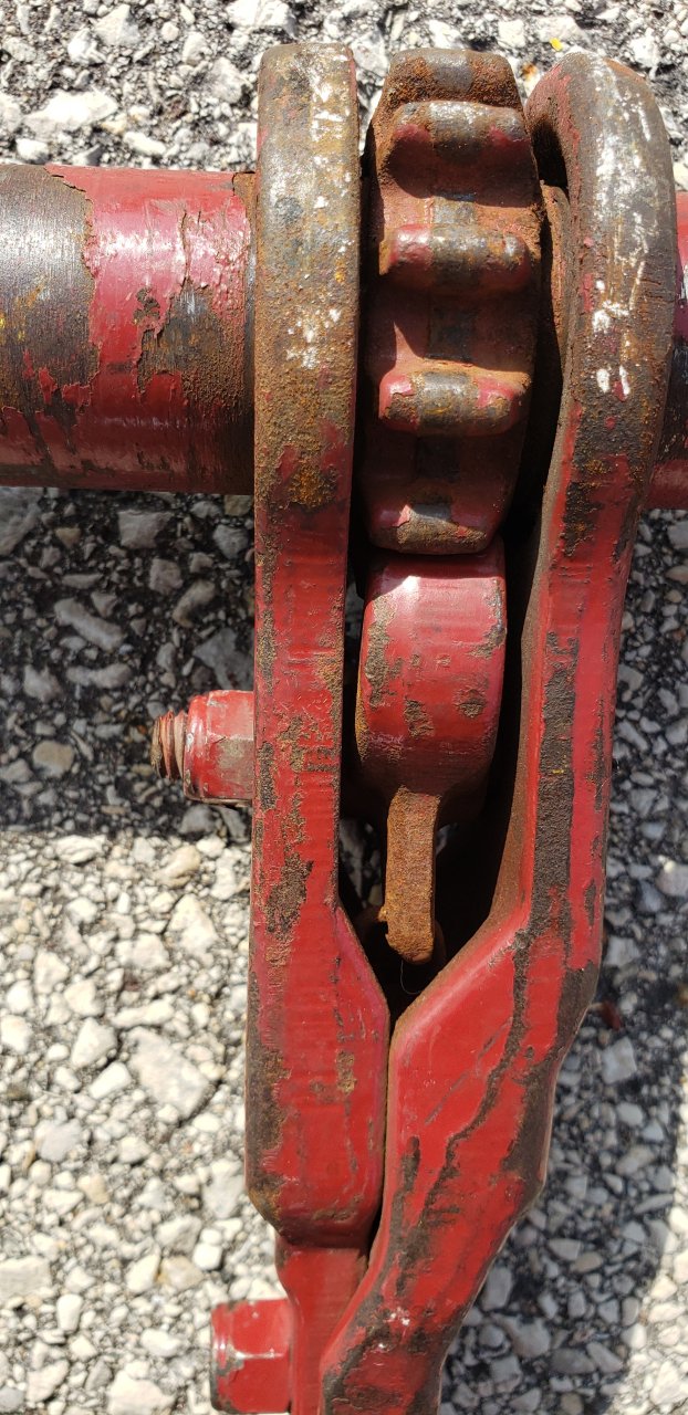

    With binders theres definitely a big difference. The American made are bigger and all around made much much better. 20190817_161322.jpg Yellow Chinese Red American.
    On these chinese binders under the lever switch is that little nipple. Once that breaks or gets stuck or whatever the binder is unusable. Which has happened to me more than once.
    On these American binders under that lever switch is a little spring type clip that hooks on to one of those two nut&bolts that's on the handle. Much easier to use. I believe if it does break you can undo those 2 bolts and put a new clip on it. So far I've never had issues with these.

  11. spyder7723
    spyder7723 Road Train Member
    15,471
    25,078
    Mar 31, 2013
    sarasota, fl
    That the yellow binder is made for 5/16ths and 3/8ths. The red is made for 3/8ths and 1/2 inch. Binders always fit two sizes of chain.
