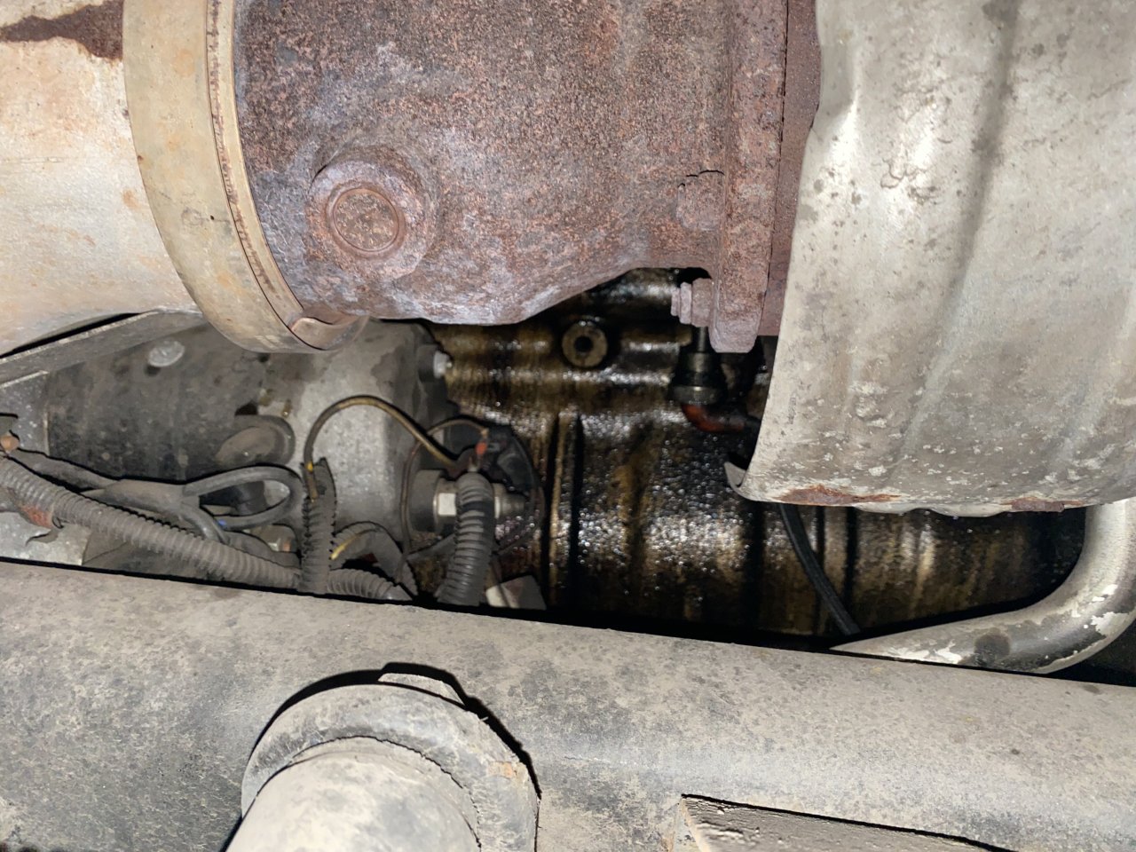

    I test drove an older FL day cab single axle, automatic. I believe it has a Mercedes engine and don’t know much more.
    One of my questions is in regards to the truck(bobtailed) rolling back on an incline at a red light waiting for it to turn green. I took my foot off the brakes to give it some gas and it reved and rolled back not engaging the gear right away. So my question is, is that a normal thing and if not, what can I be looking at as far as repairing it? It’s the same thing when parked in Neutral and putting it in gear.. it takes a bit for it to engage.
    I added some pictures of the 2 things that caught my attention. There was oil on both sides of the engine and that one pipe that looks wet was smoking a bit. Other than those things the truck runs smooth and I do plan on taking it to get overlooked if I do proceed on buying.
    I have no experience driving an automatic, so I found that weird and here we are so any information is useful to me. Thanks in advance and happy holidays.

    Have the clutch checked for wear..
    It should engage between 700-750 rpm. If it's not something it wrong

    Most automatic trans in big trucks are actually automated manual transmissions with electric clutch actuators. So they will have the same slight delay engaging just like a manual transmission does as you let out the clutch pedal. So in your case, you would need to hold the brakes on slightly just as you start to feather the throttle to move forward.

    Not a fan of automated manuals here but a newer one could suck me in. That would depend on the task to be done.
    On the older ones they tended to have some quirks. I had similar problems with several. Then when driving one with another driver riding he said just mash it to the floor. It will find something, that's what I did and it did.
    Google how to get flash codes. Eaton Fuller Auto Codes type searches.
