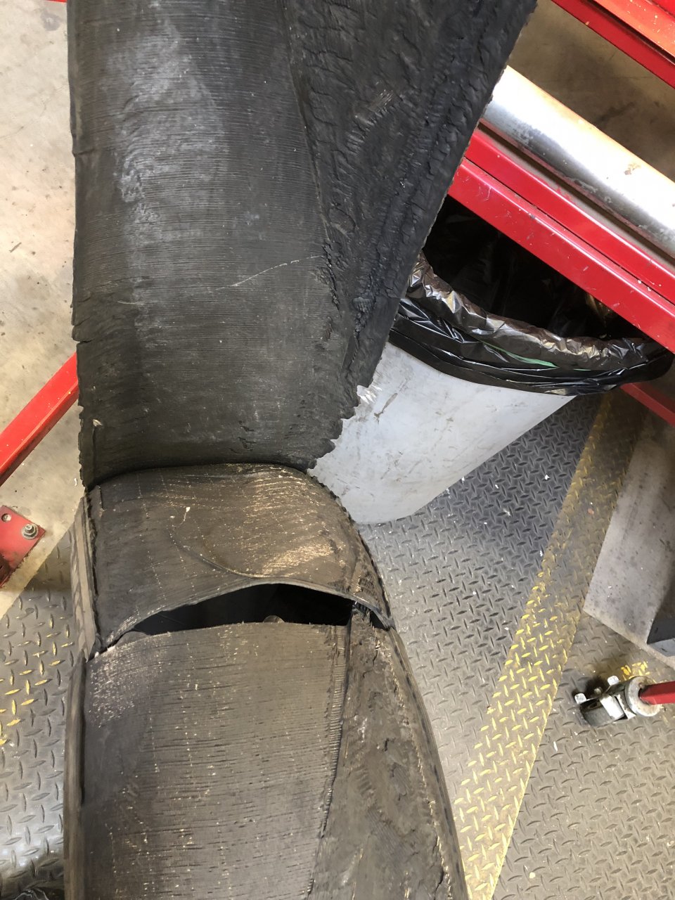

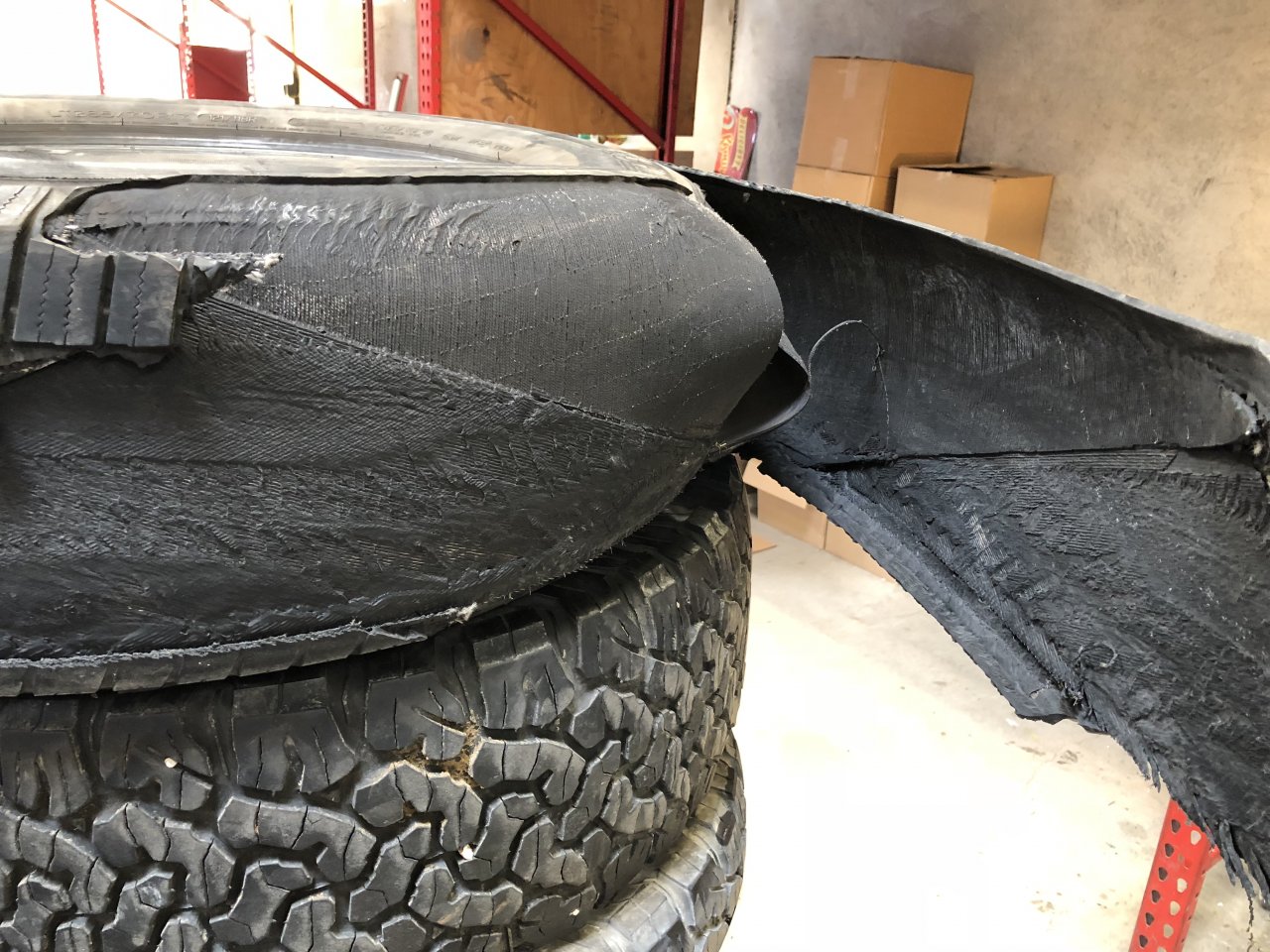

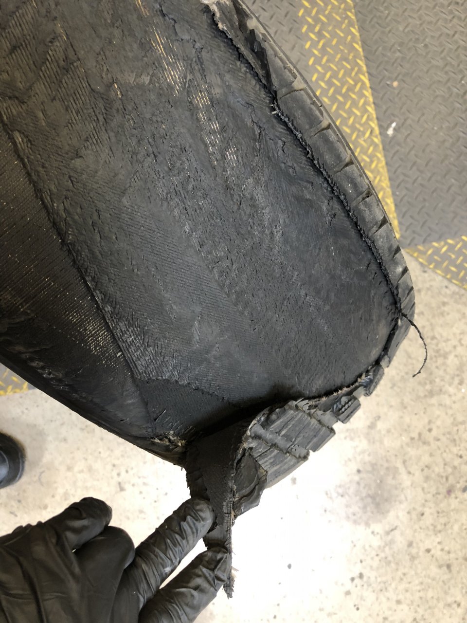

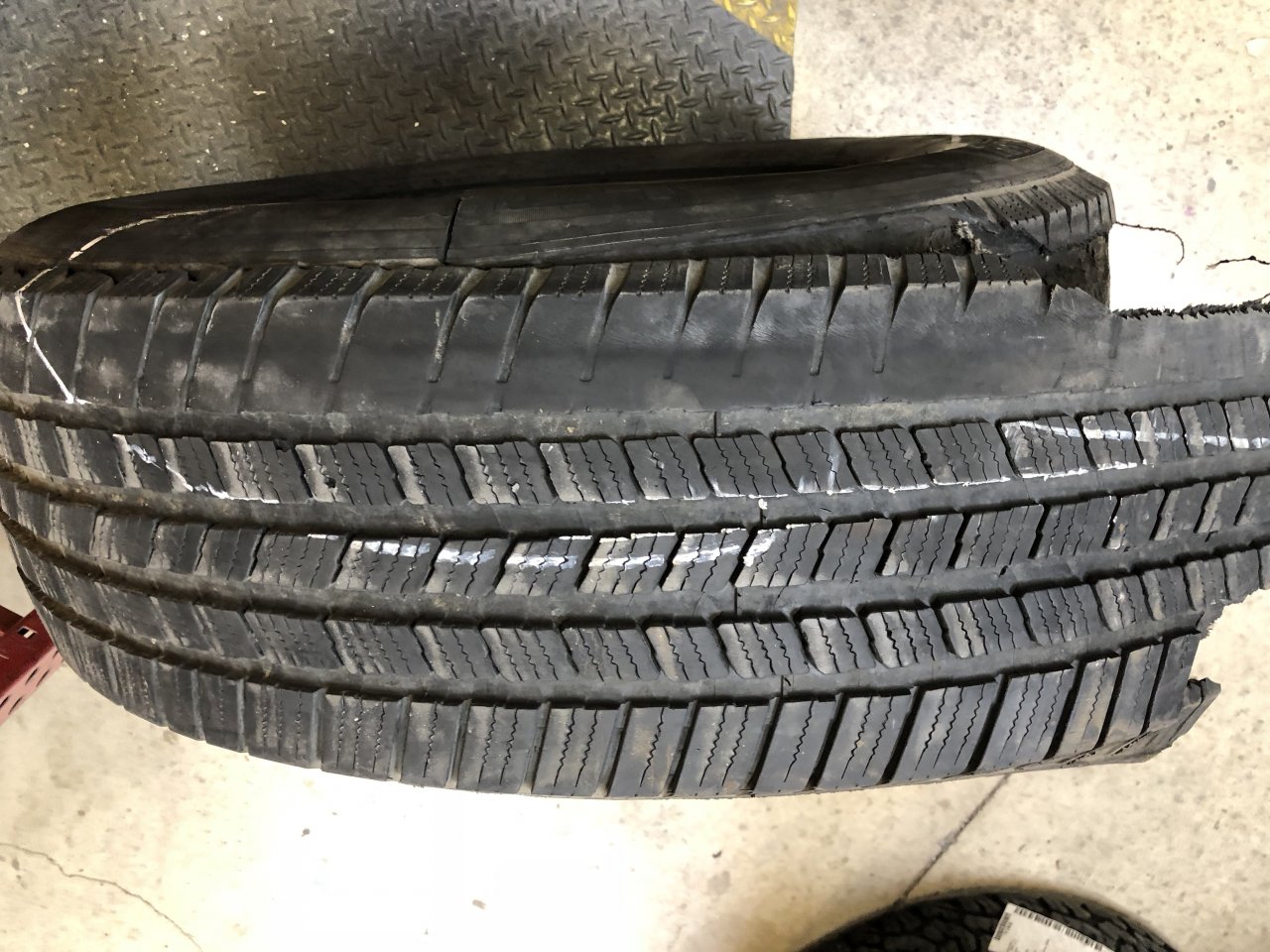

    Here is a virgin Michelin that I’m inspecting today for T-sep. look at how the tread is peeling off. The radial break (sidewall to sidewall) is were the rupture happened. It was caused by a hard road hazard impact with something at sometime in its life and low air pressure. The last pic is what the tread wear looked like before the rupture. A5D03D6F-984F-40F3-A86E-16C97CDC290B.jpeg A280DAFD-2369-4293-AAB7-E94CC727C9F8.jpeg A4E296BE-8DA5-438B-823A-B728B214C909.jpeg E568F734-4D9C-4BC2-A9F9-5B37F760689C.jpeg

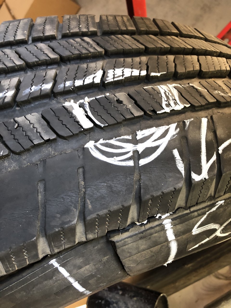

    82E59F7B-5296-4DA3-8003-6EB340D1BD36.jpeg The ultimate cause of this failure was a Puncture from something that allowed moisture to get to the plys under the tread causing the Seperation. That is why no matter what kind of tread a proper repair is important.

    If that tire were a retread people would blame it on that fact only if they saw that gator on the road. Not the little nail puncture that happened 6 months or a year ago until it failed.
