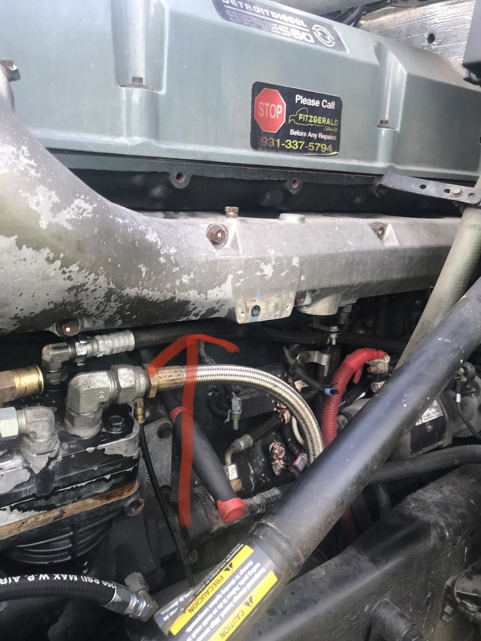

    Ok I’ve replaced 2 of 3. The last one seems to be under pressure. I’ve taken the top off the coolant reservoir to relieve some pressure but it didn’t work. Anyone know how to take the pressure off this line.....

  7. Rideandrepair
    17,548
    56,858
    Aug 8, 2015
    Looks like a broken wrench on it? Is that the hose to the air intake? Where does it go? Regardless, take the SS hose off, along with the elbow out of the head, to gain access. If it’s under air pressure, pump brakes down first. Be sure to use some pipe dope, on threads before re installing elbow.

  8. Rideandrepair
    17,548
    56,858
    Aug 8, 2015
    Should be 2 coolant hoses, 1 oil supply hose. And 2 air lines,1 pulls in air from intake manifold and the other stainless steel one pumps air pressure out to the system.Looks like you may be able to remove stainless steel hose and loosen the elbow just enough to gain access, if you can’t take it all the way off, without removing the other elbows.

    No in that picture I have a crows feet wrench on it, I don't have any problem getting to it.......
    It is a coolant hose as you can see in the middle of the picture there is coolant that has dried from leaking from that line. I drained the air tanks which I thought would relieve the pressure. I let it cool down overnight so maybe it will help. Ill see this morning.....

    It runs to the side of the engine block. And yes I think its under pressure. I can tighten it, then I can loosen it back to where it was before I tightened it but can't get it any more loose because of the pressure. Its definitely a coolant line. I already have the hose to the air intake off in that picture....
