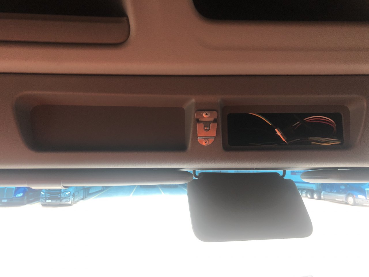

    I’m a new driver. Like 2 weeks on the road solo.
    I drive a 2019 Peterbilt 579.
    I’m trying to install a cobra 29 LTD Classic.
    I can’t lol.
    let’s start by saying I’m not technically inclined, though by what I’m seeing I shouldn’t have to be.
    I’m looking at the open slot, and I see the antenna wire, a power input, and the speaker cable already preinstalled.
    However, the center CB panel isn’t large enough for the cobra 29 LTD classic.
    there’s a similar panel on the left of it that does look big enough, however there’s a plastic cover on it, and I’m too stupid to figure it out.
    Any help would be greatly appreciated!

    pocket knife...cut hole...problem solved!

    I’ve managed to get it installed...I think.
    I’ve got power, but I don’t hear anything lol I’ve never had one before
