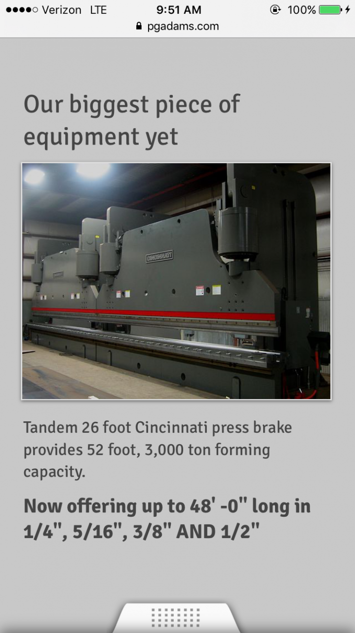

    Name of shop with a 100 ton 20 foot Brake?

    PG Adams makes frame rails: they have a brake that does 53' worth of 1/2" at a clip last I heard.
    Websites must not update often: I saw pics from the new press getting put in. I remember 53' because I wanted to know what wheelbase that'd come out to ;)

    You know what, I'm dead wrong: Logan Steel in Meriden CT got the 53' brake for 1/2".
