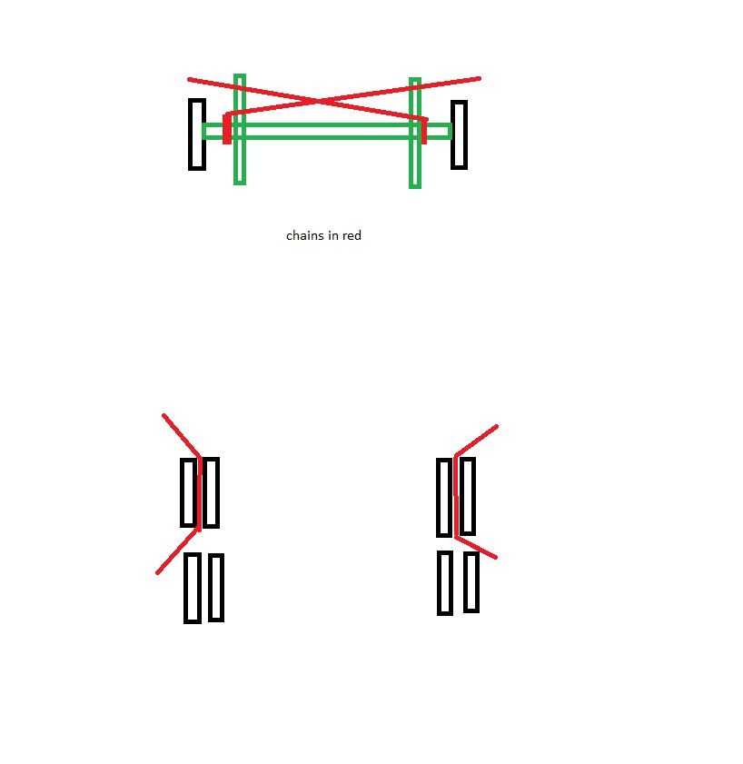

    I have only hauled wheeled stuff of my own, but more and more have been using straps around the tire like car haulers. I think id use my short straps and 4" hand ratchets wrapped like a cancer awareness ribbon. I feel that its more of an independant securement.. Meaning if i lose the other corner the whole thing isnt nullified, like crossed chains that need each other. The strap wrapped wheel is being jammed a bit more downward and also forward/aft all in one.
    Not that there is anything wrong with cross straps or chains at all. I just enjoy not laying underneath the nose while rainwater is dripping in my crack.
