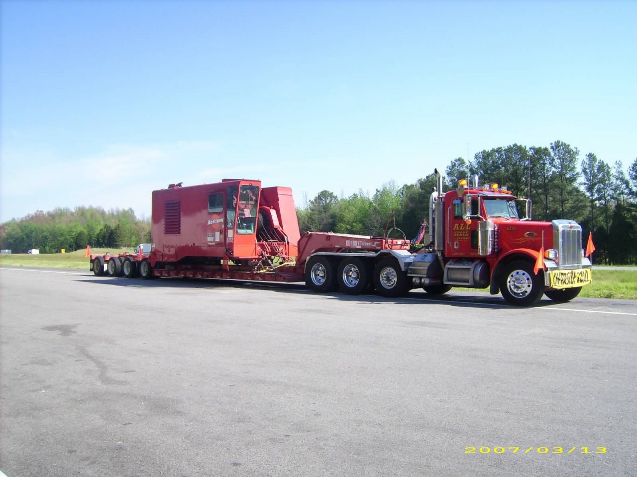

    They're top heavy for sure, the house on the other hand is a sweet load. This is in Tennessee on I24 a few years ago, I always like this picture. IMG_1964.JPG
    Oxbow, Ruthless, tucker and 10 others Thank this.
