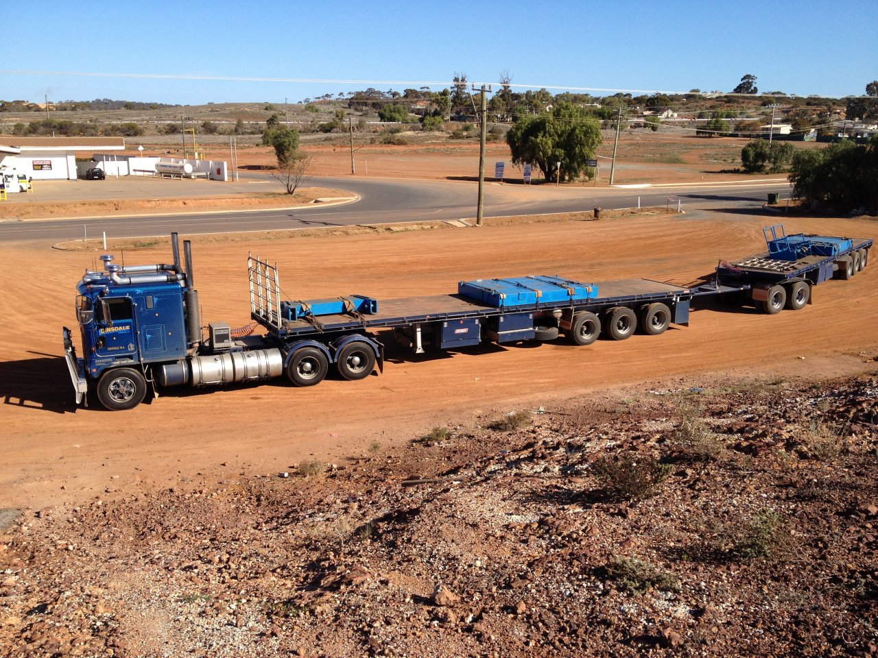

    First pic isn't a perfect example. If that was your counterweight the X would be on the front face, with the chains alternating going on top then under to the other side.
    Bulkhead should be as tight as possible. Figure out where you want the load. Build your bulkhead, load the piece behind it touching the load to the bulkhead. If you try to do it after loading you may not have a stake pocket in the right spot.
    Both are used to stop forward momentum in a hard brake. You could probably add your X chains to your aggregate but I do not.
    You know what an aggregate is, right?

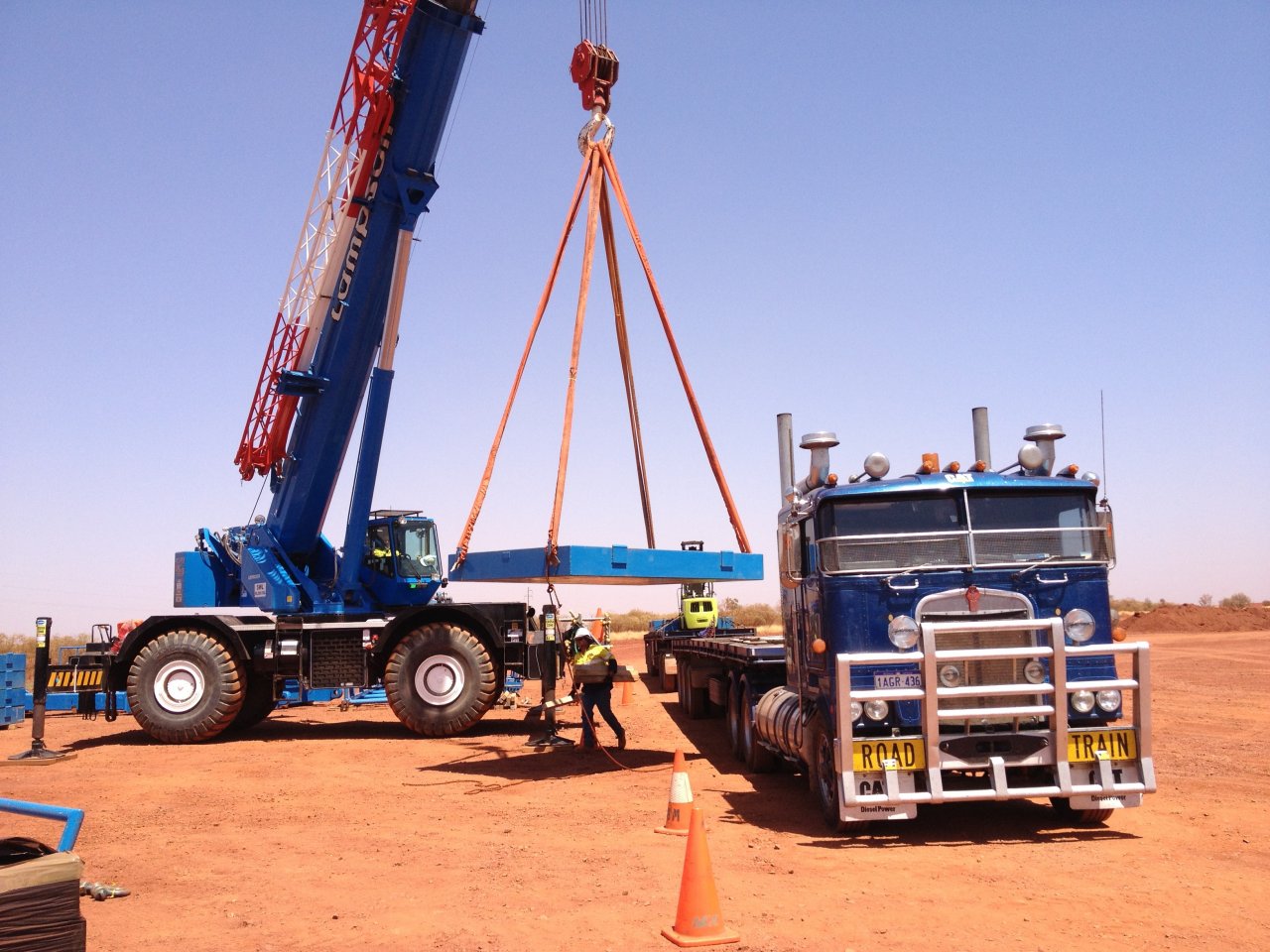

    Hard to tell from that picture, I'd say not under the load. Take a good look at the shadows from the trailer and the slab being lifted. He appears to be at the edge of the shadow, with the load to his left.
