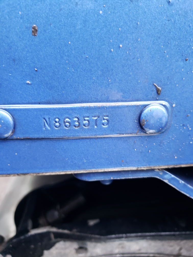

    Ok, Im going to swap out my sleeper for a different one, a 70 inch with the dual windows/doors. However, the interior I want I have only found on a couple of 2003 Pete 379s and 1 2007 379x and a 2016 389. Anyways, called peterbilt and they could figure out anything other than the interior was called the American/Canadian Platinum sleeper kit. However, when he looked up the part number, it didnt show the cabinets across the back wall. I need to know what it is since thats what I want. I have added pics for reference.

    Grab the vin off of the next sleeper you see with the interior you like. There is a tag riveted to the bottom of the back wall of the sleeper near the left shock mount. Pete should be able to find it for you then.

    Found one and got the vin
