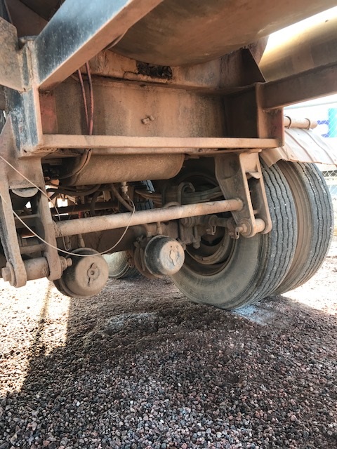

    Thanks Wis Bang. I bought this trailer from one of the local counties here in Colorado. They owned it for 10+ years and it was fairly well maintained. However, there is a rusted cross member. Planning to plate the cross member. Hope this is the extent of the rust... It is insulated.
    It was really dirty in this picture.

    The frame rails parallel to that cross member and hidden by the wrappers can rust in the same fashion and the tank will start to crush them, hence my warning about the outlet getting close to the bumper.
    make sure that the person who plates the cross-member knows his stuff and uses a thick material. A full load won't slop but will put maximum loading on those frame rails...
    If this is a 'Spec' trailer [the serial number plate will have that listed] any repairs that include welding onto the barrel requires an ASME shop with a R or U stamp to maintain specification.

    Thanks Wis Bang... I don't see anything that says spec on my serial plate. This is an old trailer. Like 1972.
    I don't even see any ASME shops in my area. If this is not a spec trailer is there a problem with not using an ASME shop? My welder is really good. Went to UTI... Builds race cars. I just don't want to end up finding out I didn't get an R or U stamp on a roadside inspection.

    If the mfg serial number plate doesn't say MC Spec 303 or 306, etc. it was a non-spec trailer, not specified for haz mats. don't worry about it. even a spec trailer built back then wouldn't always have a U stamp unless it was a higher pressure vessel.
