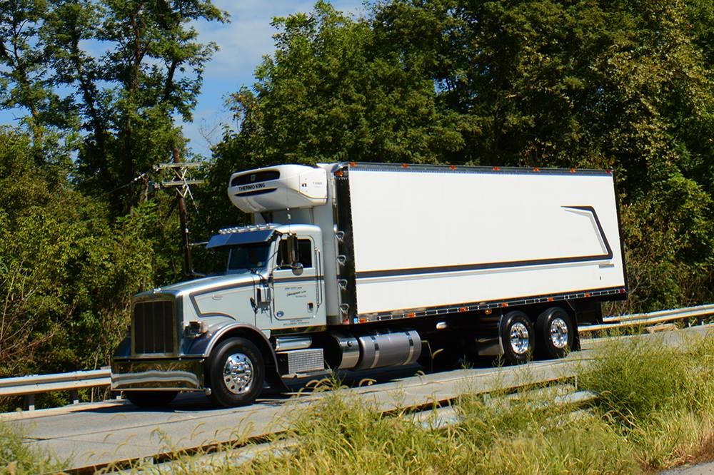

    @fredrd
    That would be cool to have. Saw this pic today and wow

  10. fredrd
    fredrd Light Load Member
    153
    8
    May 10, 2012
    That truck looks ######. I went with a 380 isl and eaton 10 speed and 3.90 gears.. the Allison auto was showing a 1% lower grade ability so I didn't want to chance it.
