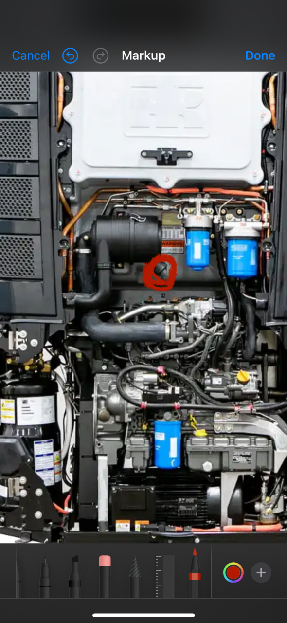

    I'm in a bad spot here. Thermoking isn't cranking after ran out of fuel when I was asleep. I have primed it alot and it turns over, but won't crank. Got frozen products and temp is going up. Can I use starter fluid since it's an emergency? Where exactly are the intakes on thermo kings usually?

    Starting fluid should work fine. Just don’t spay a whole boat load. Look at the picture attached. Spray inside that little tube with rubber boot on it that I marked red

    Better way to do it might be popping off that metal clip, removing air filter and spaying directly inside air intake tube. Shouldn’t be hard or time consuming to do.
