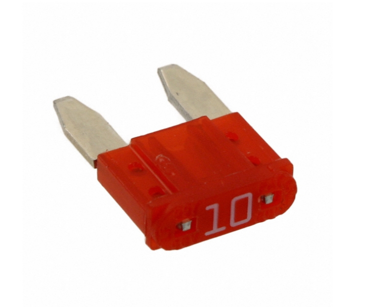

    On the fuse box panel will be a schematic laying out each fuse position, function, and its amperage.
    I'll bet the radio fuse is blown and needs replacing. It's probably a red 10a mini fuse.
    Of course, if it's blown, you'll want to find the cause, and that's a job in itself.

    So, it's not a fuse issue, as I have constant power to the radio for the memory wire. I should have an on/off wire that cycles with the key. But instead of cycling with the key, it only cycles with the lights when the truck has the key in the on position. If the lights are on and the key is off or in auxiliary, the radio shuts off. So you're missing the whole concept of how car audio wiring works. I posted this for someone who actually has knowledge of the trucks wiring system. I didn't have this issue when I had installed an aftermarket stereo in a freightliner, but why it's different, that's my question. So no offense, but unless you have deeper knowledge on the actual wiring, please just don't throw curveball guesses that don't mean squat. If it was a fuse, I wouldn't have power to the stereo at all.
