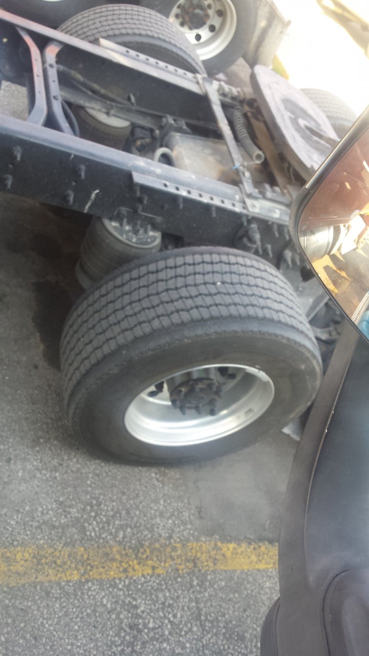

    Looks like a Michelin Xone line energy D. Possible recap but don’t think so but the edge wear is from over inflation. A poor cap wouldn’t wear even around tire just on shoulders

    And look at passenger side tire. Same shoulder wear. So the air pressure would be more the same than the exact same poor cap process

    Max is 120 psi cold . We run them around 105-110

    Max for super singles?

    My brother in law is a rep for Michelin, he’s worked there 15 years. He does both trucking and earth moving tires. He told me Michelin recommends around 80 psi on the XDN2 which isn’t a super single, just a regular drive. It gives a better contact patch, I will ask and see what he says they recommend on a X1.

    Underinflated. Overinflated wears the centre of tires.
