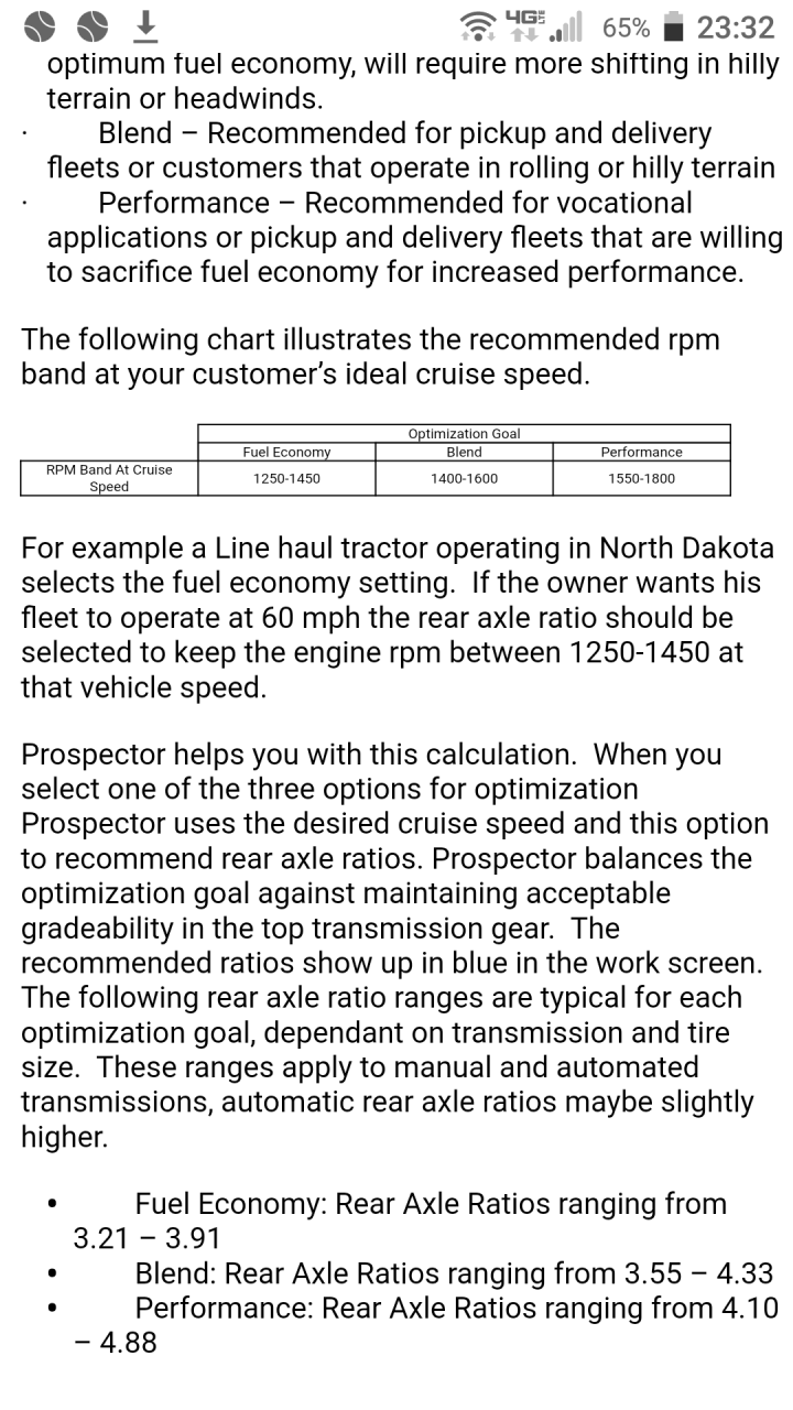

    Here is brochure for EPA 10 engines and how supposed to be speced gear wise. They tend to need more RPM vs EPA 13 and up. Screenshot_20190704-233242.png

    Smaller engines like to wind more than the large engines. With my 2 B trucks and my N14, it was ok to pull them down, even to 1,100 rpm. With a 12.7, pulling it under 1,400 is discouraged.
    Intothesunset Thanks this.

    Well the mx13 I’m with seems to pull best between the 1200-1500 range after that it loses most of its pulling power. These small engines like to run low anything past 1500 you’re wasting power and fuel. Now I would rev it to 1700 if you’re coming up a steep hill just so the turbo gets going by the time you get lugged to 1500-1600 so you can get the most pull.
    If you’re already doing this you’re just not used to these weaker emissions engines. They don’t pull like the old CATs or Detroits. Just a world we live in now. That’s why I try my best to build up speed if I know I’m climbing a hill that way I only have to gear down maybe once.
