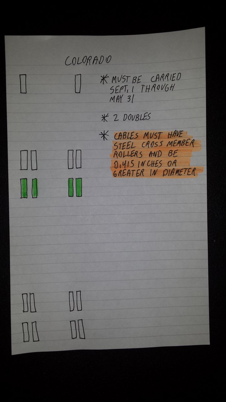

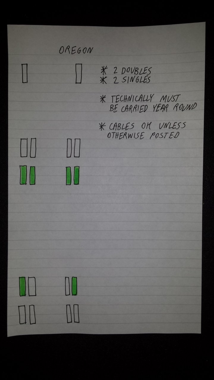

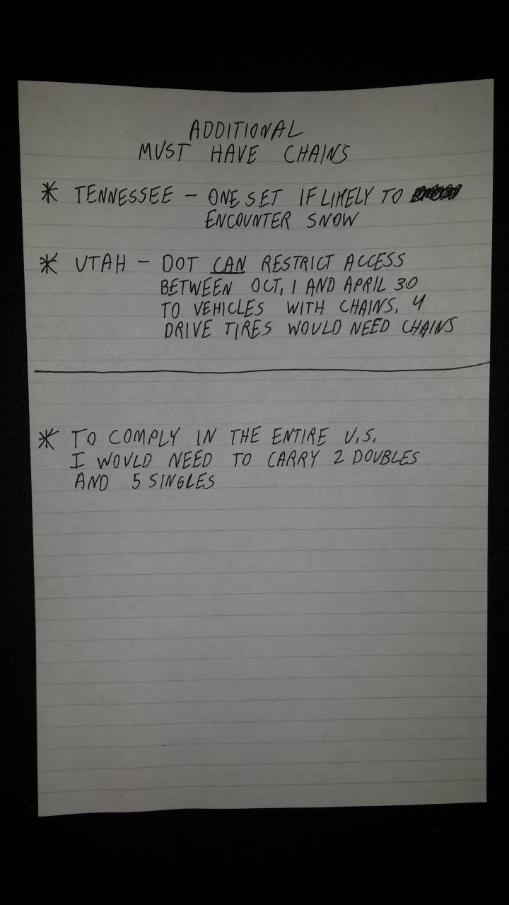

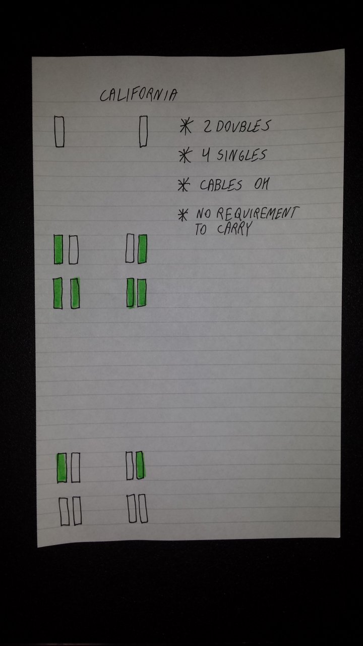

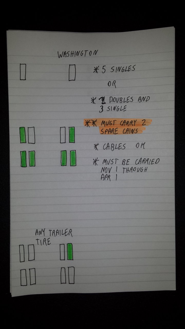

    Well my wonderful company was not sure what I would need in regards to tire chains so they said to let them know what I need. This is my understanding. I know there are other options on how to chain up but this is how I would do it based on what's required and minimizes the amount of chains that I need to carry.
    Oh and to keep it on topic I pull a flatbed so my trailer chains would be on the front axle because it's the easiest to access.
    So to my understanding the minimum I need to carry is 2 doubles and 5 singles.
    Comments? Corrections? 20160909_094828.jpg 20160909_094847.jpg 20160909_094908.jpg 20160909_094812.jpg 20160909_094919.jpg

    You forgot that some times you need chains on the steer. But then when it is that bad it is better to park it. We always carried two doubles and four singles

    I carry 5 doubles and six singles
    4 doubles and four singles on the rack

    Shoot if chains are required period I'm parking. I'm lucky enough to work for a company that allows me to be the captain. I'm just trying to make sure I'm carrying the minimum amount to be legal.

    I"m curious as to the FIVE singles.
    Axles have to be chained on BOTH sides. All you need is 6 singles. Some states might want 2 singles for spare but have yet to see it enforced. California is the only state i've seen so far that might actually make you chain both drive axles. They don't plow the top of donners much. So that stretch is usually the worst part of the drive.
    You can pack doubles if you desire. But it hasn't been necessary. Least not in the 6 years i was OTR.
    6 singles is all you need. And that's all most truck drivers with brains carry. And i say that because you will encounter a lot of unprepared drivers. No idea how to chain or have no chains at all. PERIOD. It astounds me how many drivers will sit on donners looking to buy or borrow or rent someone's chains. As if we pack spares to lend out. SHEESH.

    5 because Washington requires 2 spares.
