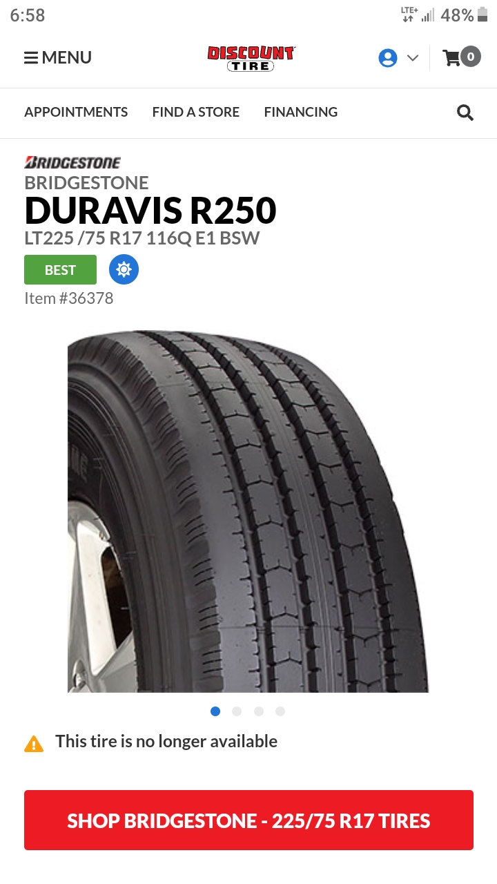

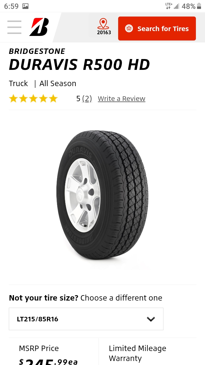

    Didn't have air assist on my dually, but went 118k on a set of these R500 HD's on the drive. I loved them, thought they were great tires..
    Now I can't recall if you have a 2wd or 4wd F350?
    I'd consider running a steer/drive setup like this & just rotate the steers side to side if 2wd. R500 HD's out back & R250's on the steer axle. When they start to cup run em out on the trailer. You'd loose a little axle capacity though as the LT235/85r16 is only good for about ~3100lbs vs the ST trailer tires at about ~3520lbs..
