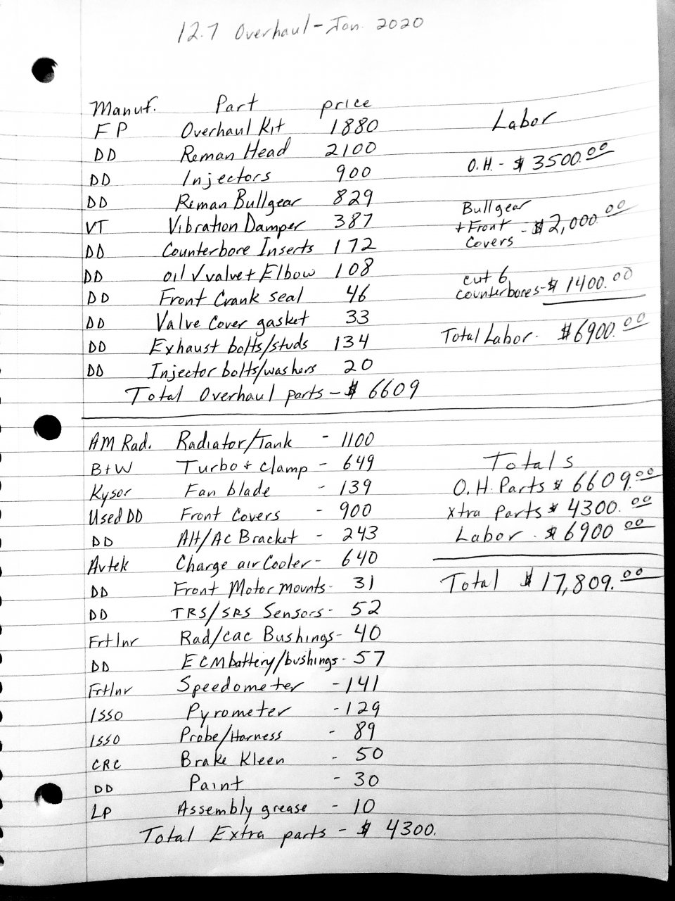

    Here is what @Rideandrepair just had done to his truck
    lynchy, rank, FoolsErrand and 2 others Thank this.

    And a ton of what he had done is not included with a basic level 1 inframe. Bull gear for example is 15 hours if I remember right.
    A basic inframe is rings, pistons, liners and liner o rings, piston cooling nozzles, exhaust and intake gaskets (tho I'd only change them if they are leaking, if not leaking no reason to remove the manifolds from the head), new cam bearings, and of course a new head gasket cause the head had to come off. Heck it doesn't even include new rod and main bearings, tho I always insist on them since we got the pan off and the rods out. Changing the main bearings and thrust washer only adds 2 hours and a couple hundred bucks.

    The Detroit kits don’t include the bearings,they’re $300 more. other aftermarket ones do. Every quote I’ve had in 10 yrs, for a bull gear, at least 5 or 6 quotes, if not more, were $2000, or 20 Labor hrs. That includes resealing both covers. Inframe Labor, overhauls have always been told 40-50 labor hours. Usually takes a Shop,7-10 days. I would be very suspect of anyone doing an inframe in 2 days. I’m sure it could be done, but really think, a lot of Shops will skip a lot of things. What if it needs counterbores? That’s a 3-4 hr job alone. Also needs to set for 24 hrs, after inserts are installed. I don’t want a rushed wham bam job. We spent 15 days, 6-9 hrs a day, maybe more. But He took the time to clean everything, All the bolt holes were chased, and ran a magnet through. And there’s always a snag somewhere, on an old Truck. Rust and wires that need inspecting etc. 2 day inframe? No Thank You.
