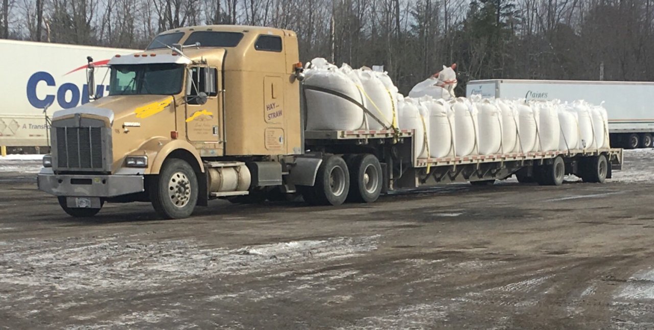

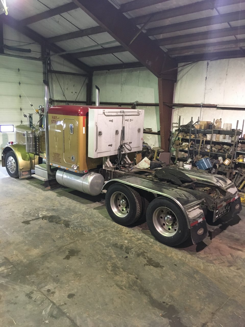

    I pull open decks but:
    1. 1986 model year 359EXHD flat top, 3406B, 15 speed OD, 3.90 gets 6.2 USmpg on summer fuel at 60-62 mph . Weights are 30,000 to 85,000. Paid $25,000 USD for the truck in 2014. Truck is worth probably $50,000 today
    2. 1998 model year T800 tall bunk but without the roof fairing, M11, 13 speed, 4.33 gets 7.0 USmpg on summer fuel at 60-62 mph weights are 30,000 to 85,000. Paid $12,000 USD for the truck in 2007. 250k on the inframe done here in our shop.....$3000 for the Cummins rebuild kit not including the cylinder head that was replaced earlier, $2,000 labor. Truck is worth probably $30,000 today
    3. 2008 model year T660, ISX, 13 speed, 3.70 gets 5.5 USmpg on summer fuel at 70+ mph weights are 30,000- 85,000. Paid $80,000 USD for the truck in 2007. Worth probably $10,000 today you almost can't give a DPF truck away.
    Even without mentioning the emission related expenses of the 2008 that exceed $50,000, I'll leave it to the loan officers and aerodynamics experts to calculate which has been the better deal.

    That's a clean looking 359, lot better looking than the old man's.
