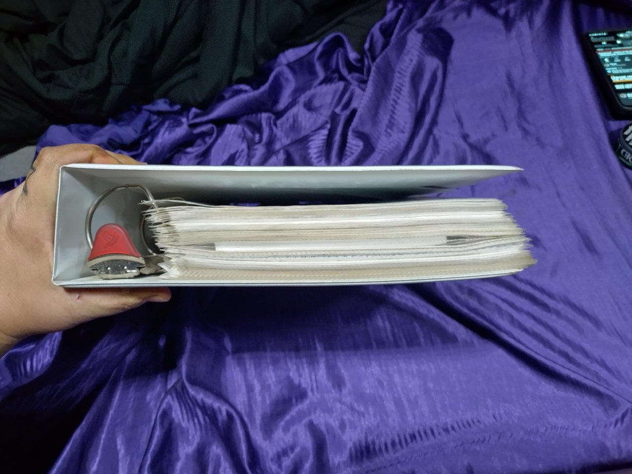

    The picture is a few months old. We only get annuals when we are going back through the necessary states.
    FerrissWheel, cke and beastr123 Thank this.

    Least I'm not the only one that has everything on hand.
    That's just for annual permits if I have them and provisions. As well as a lot of state maps for routing purposes. And a few city maps.
    kylefitzy, CAXPT, cke and 1 other person Thank this.
