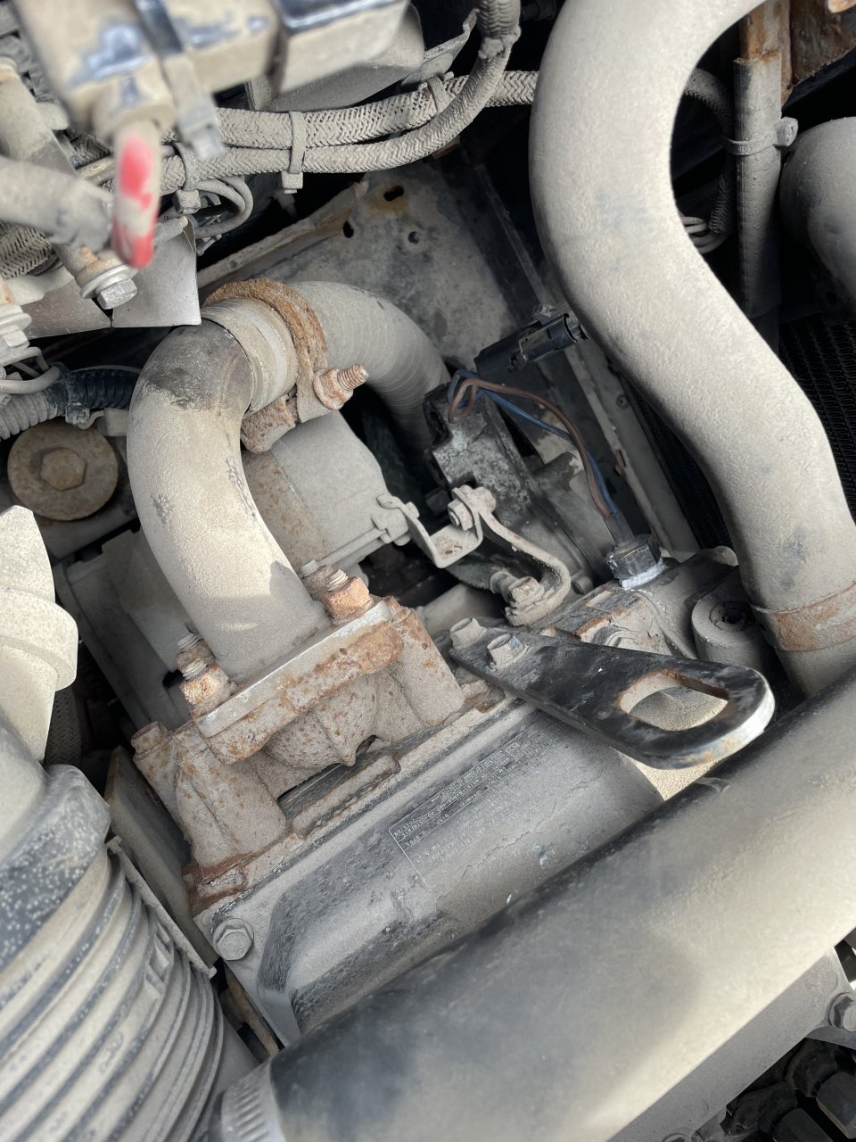

    About to order the parts for the heater. But Im still trying to figure out where the Water Temp sensor WT1 is on the APU? I think I found one - but Im guessing its the WT2 sensor? Maybe I only have 1 since my APU isnt connected to my truck - since it has its own coolant? I unplugged the once sensor I saw and plugged it back in but my APU still keeps shutting down. Not sure if the heater or a bad water temp sensor is causing that?

    It should be on top of thermostat housing

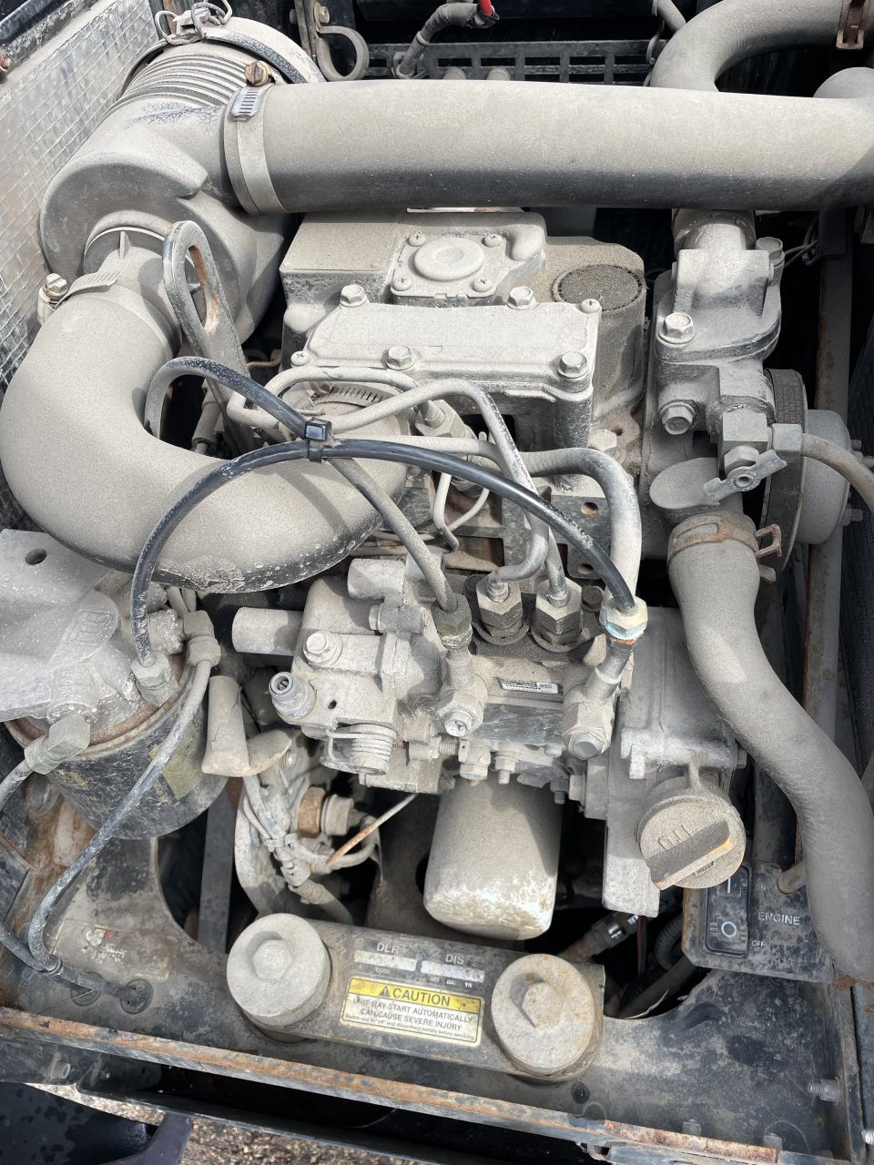

    Im sorry Im potato but I looked for a long time and only found 1, attached pics of 1
    I found and inspected, and another pic of the one I couldnt find (which I think is the WT1 sensor part#41-6538)

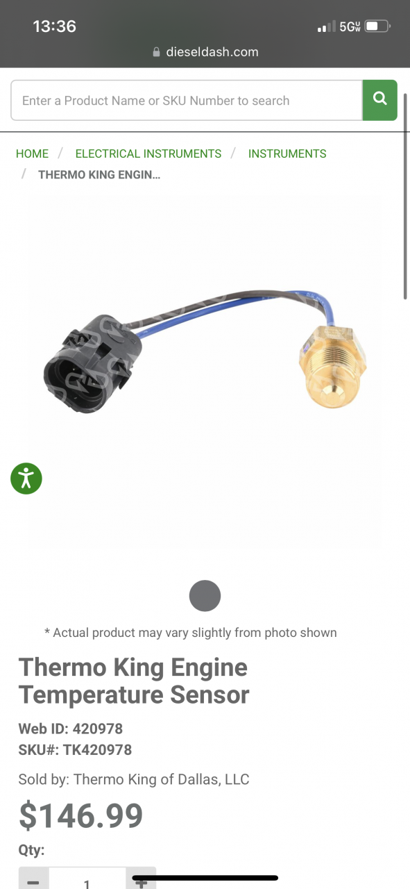

    Also Im 90% this is the water temp sensor I need to buy to replace the 1 I have that is maybe bad? It sits behind the water pump, I called ThermoKing and they want $180 no thanks
