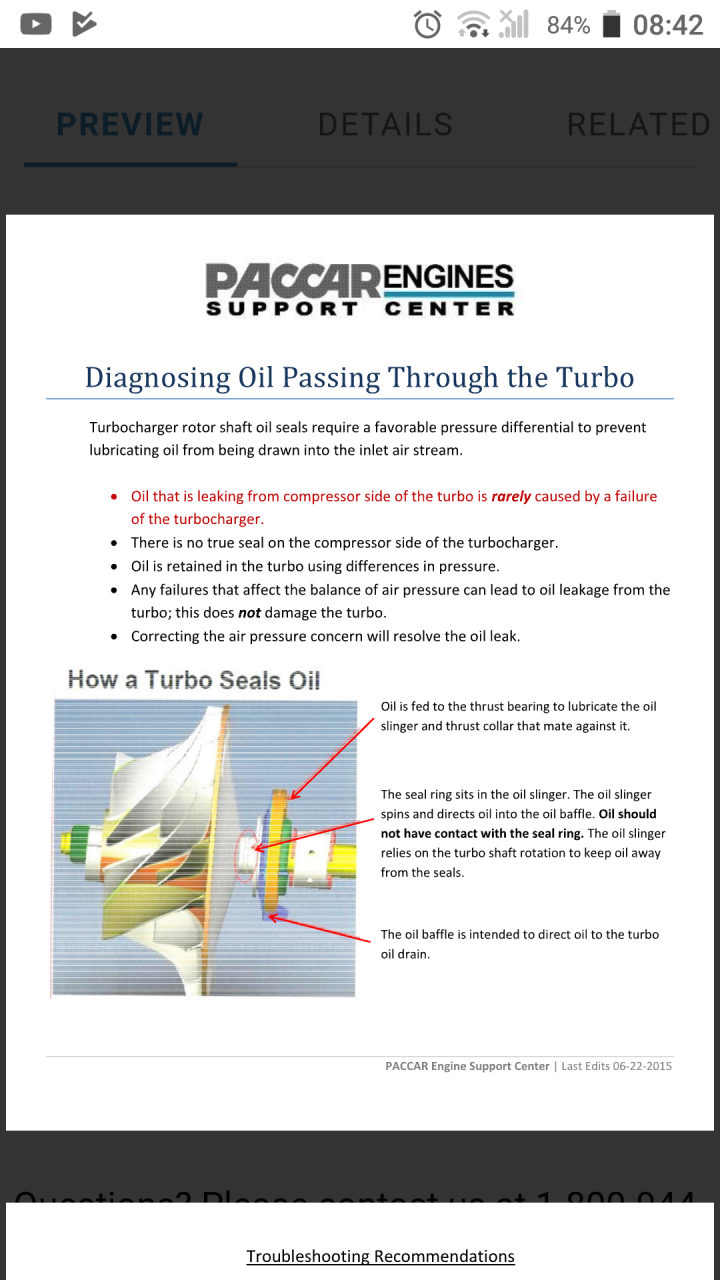

Every seems to think the rings in the center rotating assembly seal oil, but they seal gas. Oil is keep out of the housing by a ground raised radius and oil slingers. Here is a good picture of it.Oxbow, Nando85, Rideandrepair and 1 other person Thank this. -
