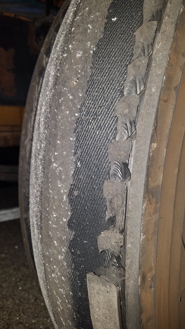

    This is what it looks like when the tread decides to leave the steer tire. Never blew out! tire.jpg

    Glad you caught it.

    Lucky that you are living right because that may have torn the fender bad?

    I don't think I've ever seen a virgin tire do that. What kind is it, and don't say that Chinese crap.

    You were very lucky not to have a blow out when that tire decided to cut loose!

    a little dab of Gorilla glue, and you're good to go, don't you have any in your tool kit?
    seriously, i had a steer tire with a HUGE bulge one time, lucky for me, it was in my company yard.
    it was a fairly new goodyear if i recall. and it got replaced with another goodyear, as that's all the garage we have'em serviced at has in stock.

    It got the fender a little bit.It was rather quick. A quick vibration, the smell of rubber and I hit the shoulder

    NEVER! I will not run them. It was a Bridgestone R283A 295/75/22.5

    Yeah, well Bridgestone would be hearing from me! I've had recaps do that all the time, but a virgin? Peel the whole tread off? Call Hupy and Abraham, right now. ( oh Bill, you were once Capt. Kirk for heavens sake, look what you're reduced to)

    There is a Bridgestone rep that is suppose to come by and get in. Unfortunately I didn't have any room to tote it around with me. The manager at the shop said not to expect anything from them though which I already knew. Back in the 275/70/22.5 days we had lots of guys blowing them (and still do) and Michelin nor Bridgestone would stand behind them. They always blamed it on the equipment/ tire pressure etc etc.
