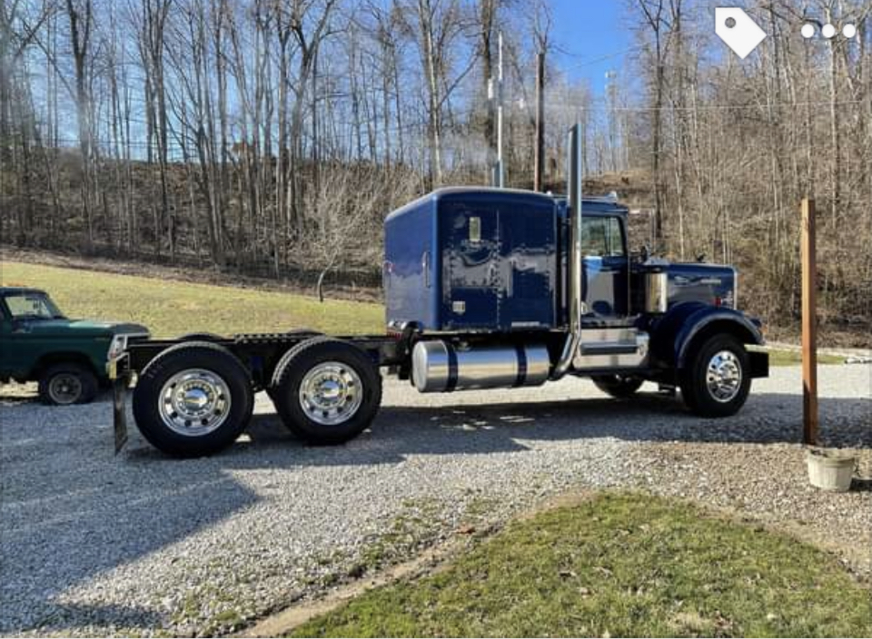

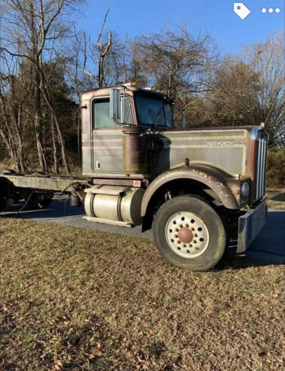

    Hope to be there this year. Friend built this 75 A model up from the naked frame rails. Not sure he’ll get it there this year but next year for sure…

    Nice. Wish I had the property and age to take on that kind of project. :)
