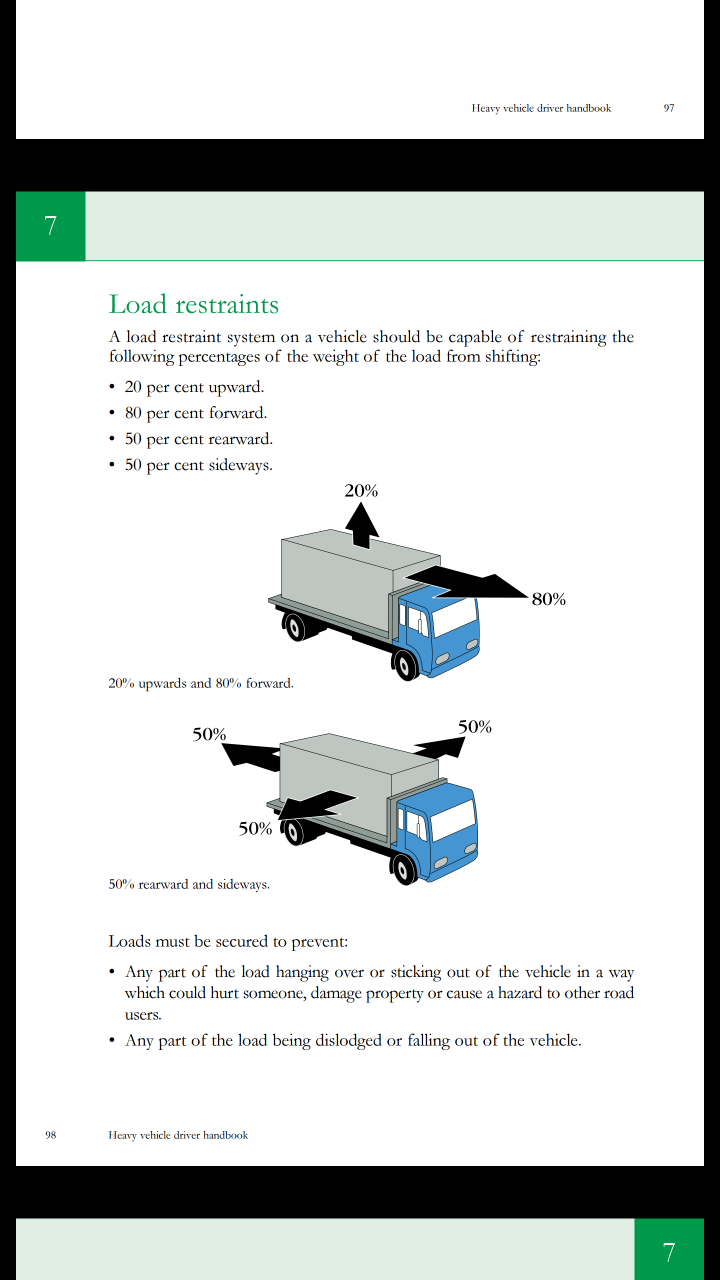

    @johndeere4020 i think you broke his head..
    I am still getting my head around the regulations that you guys run under so i know what i NEED to do.
    But in saying that from what i have noticed so far there isn't a whole lot of difference in load securement requirements when it comes to wll and so on. The biggest one i have come across is that our book actually says "if your vehicle is to tip over your load should be secured safely enough that it stays connected to the trailer"
    The reason they added that part in was that we had a lot of knuckleheads throwing straps over and not bothering tightening them up.
    That rule also applies to curtainsiders with gates. Unless they are LOCKING gates OR have load rated curtains which have steel bars running vertical every two feet.

    Honestly it's not that complicated, 50% of the static load weight is your benchmark. 100% WLL for indirect and 50% for direct. If you chain it so it's secure you usually have no problem meeting those criteria. Throw the minimum then a couple more or until your comfortable and you'll be fine.

    That's pretty much what i do. I look at it and then think about if (god forbid) it gets laid over or some idiot slams his brakes on creating a hard break. Will this load move. Yes? Where do i need to put another chain/strap. No? Is it still compliant.
    One thing i used to explain to people back home. It doesn't matter how big or small the load is. Secure it like it wants to kill everyone.
    Just downloaded our book from home and found this section. Which seems to be what your talking about.

    Do you have this?

    Yes sir they gave me a copy yesterday.
