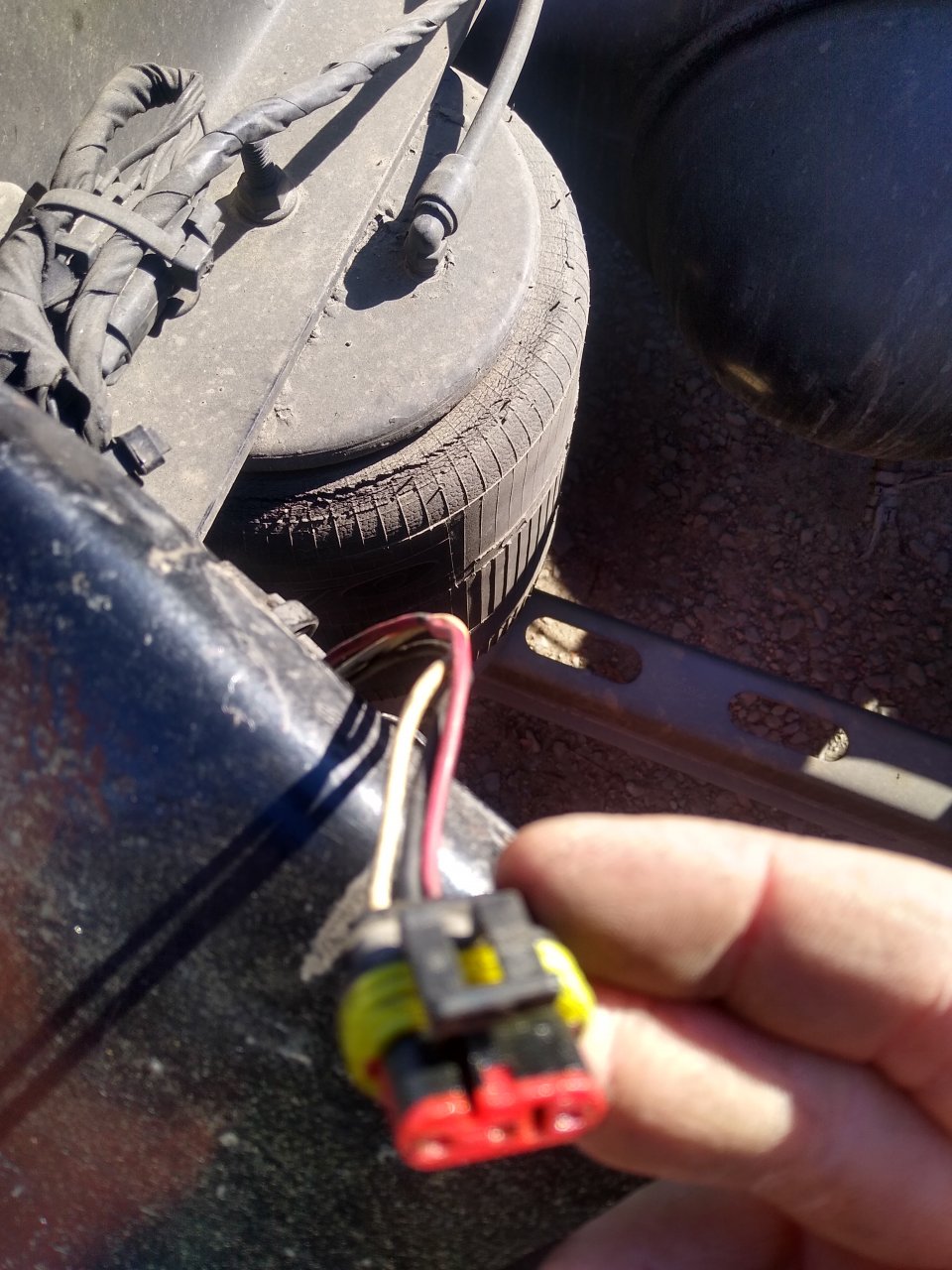

  6. teemobile707
    teemobile707 Bobtail Member
    Joined:
    May 1, 2020
    Messages:
    47
    Thanks Received:
    30

    Hello,
    There are 4 messages from the cluster; one each for the left and right side marker then one each for left and right tail lights. I don't quite remember the wording. I'll get some pics and post that tomorrow.
    The left and right cab side turn signal lights are LED's just as are taillights LED's. I believe the 4 above messages I'm seeing from the information center on the dash are because the lights may have been switched from irradecent bulbs to LED's and the computer may be seeing less of a draw from the LED's translating it to a short. I never figured out how to get rid of that check light as well as the 4 messages. Turn signals tick and block rapidly in the cab but light up at normal intervals.

  9. loudtom
    loudtom Road Train Member
    Joined:
    Aug 26, 2016
    Messages:
    1,717
    Thanks Received:
    2,805
    Check with junkyards to see if you might find a truck with the same LCM. If you can't find a part, then try to bypass the LCM somehow. You might be able to use your trailer's brake and turn signal to power your truck's rear lights. You might need a tail light converter for the brake lights and turn signals to communicate properly.
    You could try to take the module to someone who does electronics repairs and see what they say. I'm thinking it will be too much trouble finding a wiring diagram, and the module is likely sealed making it hard to service. Since it's still working for headlights and other functions, I'd leave it alone.
