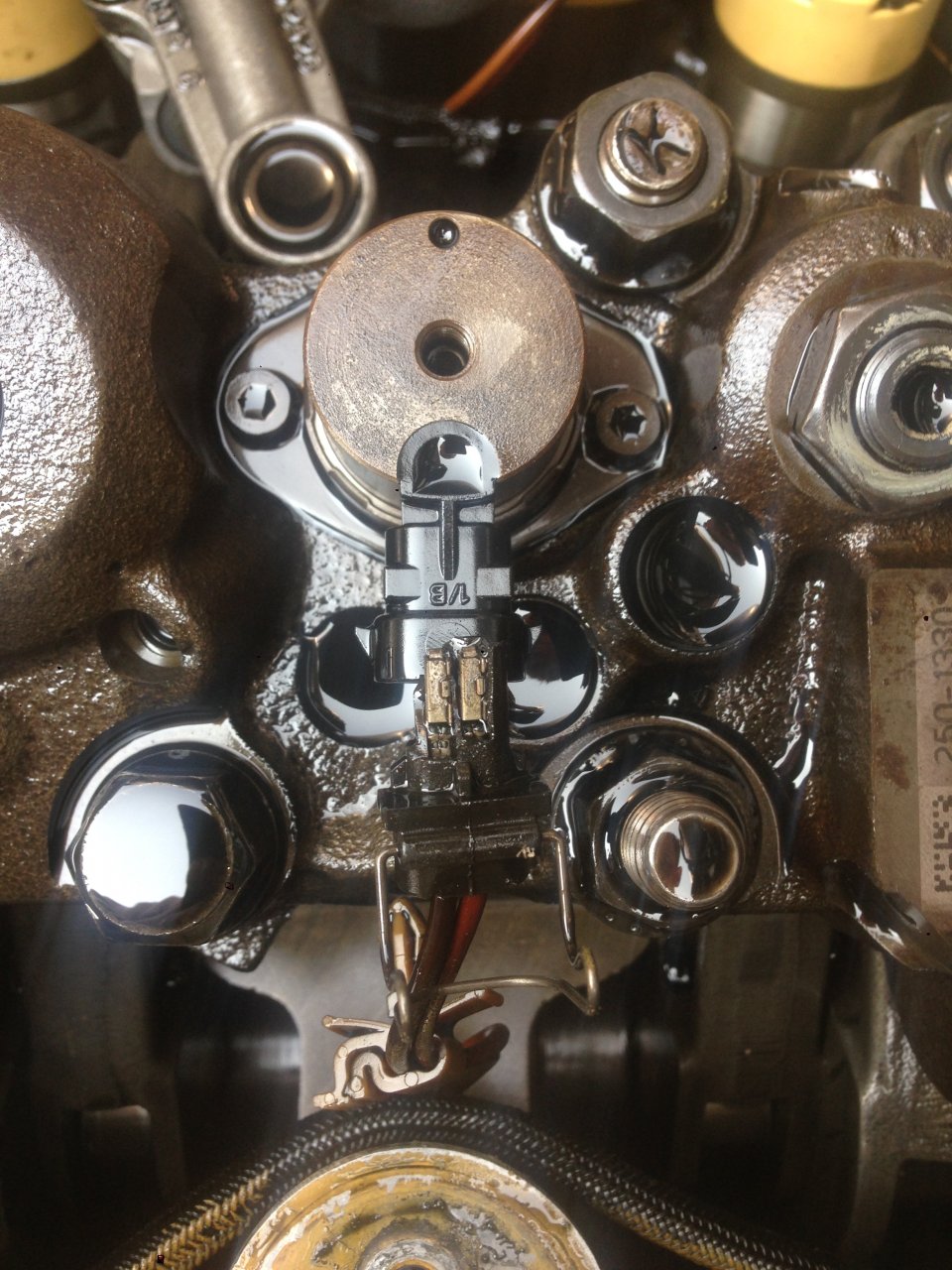

    Update: I think I may have found my problem. I got time today to take off the valve covers and inspect the plugs. The very rear jake solenoid plug had parts of the plastic missing and had both connections open to each other.
    I will add some photos. Luckily I had a spare plug in my side box cause I've had to replace a few Iva solenoid plugs as well. I think this winter I will get both harnesses and replace them.

    These had the worst setup and always are a problem weather it be the vva wiring, injector wiring, jake wiring, or oil running out of the main plugins on the valve cover spacer. glad you found the problem
