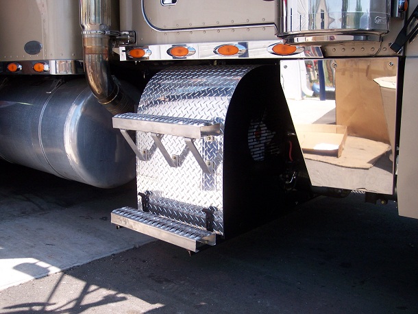

    Used rigmaster is in my future to tend batteries and provide hotel loads of electric comfort. I need to find some steps too.
    I have to mount under my passenger door because my fuel tanks are set too far back.
